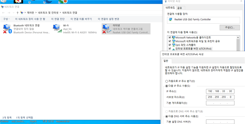

However, when setting the PC's static IP in section 4.1, it shows "Network cable unplugged" in the Ethernet options, as seen in the image below.
This occurs in both scenarios:
  1. PC-Ethernet-EVM
  2. PC-Ethernet
In both cases, it appears that the Ethernet connection is not recognized by the DSP-EVM.
Additionally, I have set the Ethernet IPv4 on the PC according to the user guide's instructions to 192.168.33.30 with a subnet mask of 255.255.255.0.
How can I resolve this issue? Are there any additional resources or references I can consult?
    Could you try bypassing the middle connector and directly connect the ethernet cable to the PC?

  • I tried the methods you suggested to connect to another PC, but it still didn't work. Are there any other options?
