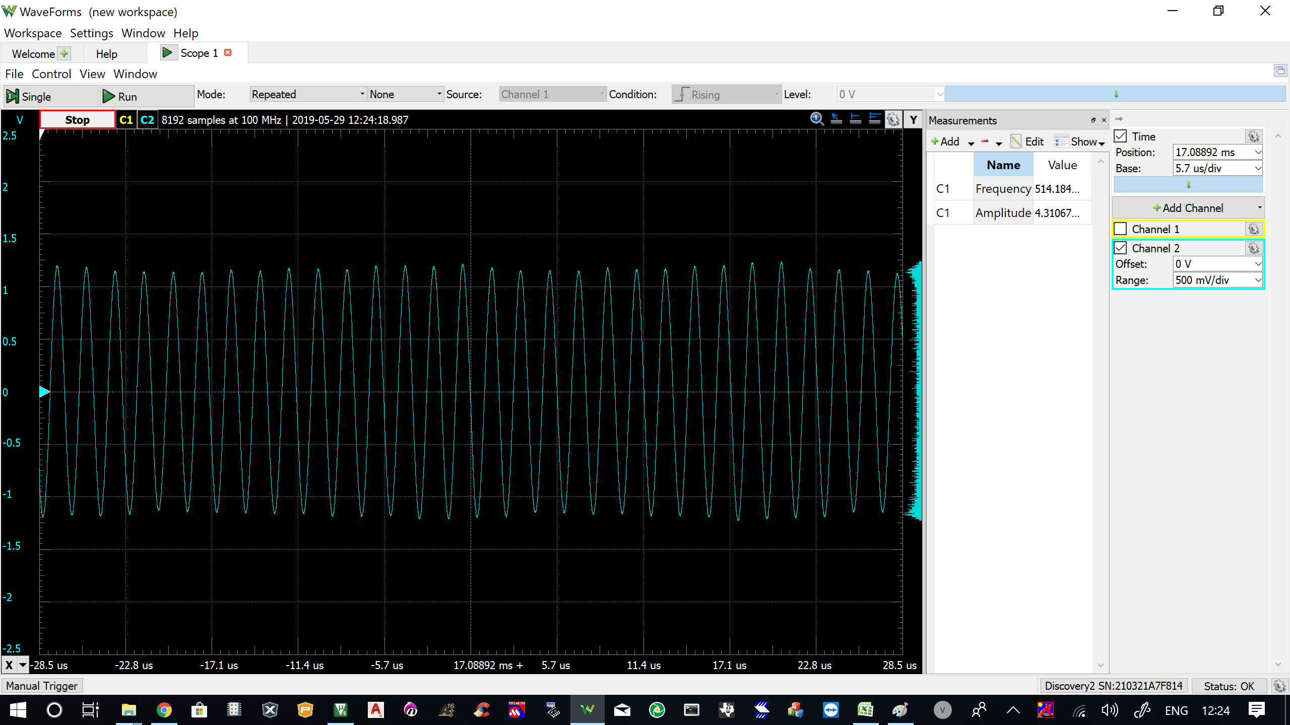

Can you probe both LDC's IN0A pins with an oscilloscope and share the screenshots? Your measured sensor frequencies are roughly 200kHz off from the calculated value for those LC values. I'd like to verify that the sensors are oscillating correctly. Is there a long distance between the sensor and the LDC1612?
Also note that when calculating the sensor frequency from the LDC output codes, you should use the Fref value after the Fref divider has been applied, which is 20MHz in your case.
The sensor frequencies should be far enough apart that the two active sensors would not affect each other.

Can you clarify how the oscilloscope probe is connected in these images? Is is a differential probe connected across INxA and INxB?
You should measure the inductance at the resonant frequency of the LC tank. This might be why your sensor frequencies are so different from the calculated values. If you have access to an impedance analyzer, I recommend measuring the LC tank's Rp across frequency to find the true resonant frequency. The resonant frequency is at the peak Rp. This value should match well with the digital output from the LDC.
