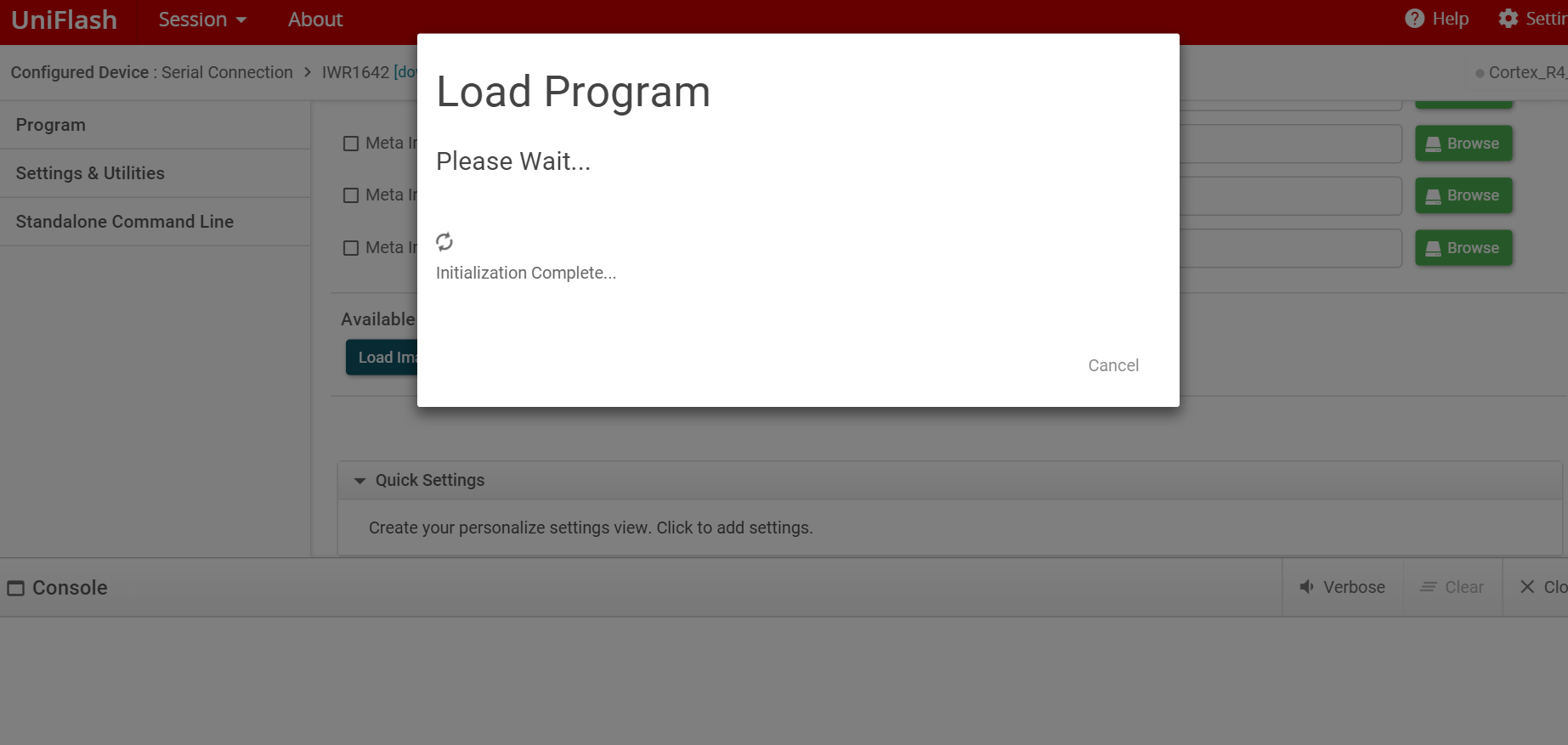

I am trying to flash the image to the device using uniflash versions (5.3.0) and (4.6.0). The tool is highly unstable and I could successfully flash only 2 out of 10 times in both Linux and windows. Everytime it reports different errors even though I follow the same procedure. Currently I try to flash the image in windows 10 PC, a pop comes up and it says 'Load Program, Please Wait, Initialization complete' and it hangs there.
Please find the screen shot attached.
I followed the below procedure while flashing,
1)SOP2 jumper is put on.
2)Powered up the device and pushed the reset switch.
3)COM ports are successfully detected (COM 3 : Data Port and COM 4: User UART)
4)Run the Uniflash tool (Windows 10 , Uniflash version 5.3.0)
5)Selected the 'IWR1642BOOST' device from device list and clicked on start
6)Selected COM port as 'COM4' and unchecked erase Sfalsh option
7)Selected the *.bin file and clicked on Load Image
1. You don't have to uncheck erase flash
2. Check to ensure you have SOP 0 :2 set for "1 0 1"
3. can you try a different PC
Charles O
Hello Charles,
Thank you for your reply.
I flashed the boot-loader and firmware using emulator as per the discussion in the below link,
https://e2e.ti.com/support/sensors/f/1023/t/869214
And now i am able to flash other images as well. Board is booting now.
