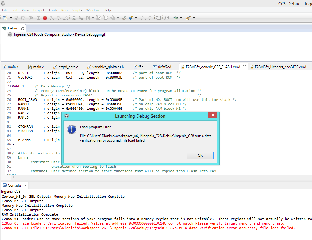

  • Hi Ricky
    I installed the  6.1.0.00104  version from the scratch, a clean installation.
    I have already installed the 5.5 version in the same hard disk and it works.
    The message that I get when try to connect the C28 or load the code is:
    Cortex_M3_0: GEL Output: Memory Map Initialization Complete
    C28xx_0: GEL Output:
    RAM Initialization Complete
    C28xx_0: Loader: One or more sections of your program falls into a memory region that is not writable.  These regions will not actually be written to the target.  Check your linker configuration and/or memory map.
    C28xx_0: File Loader: Verification failed: Values at address 0x000000000013BDA2 do not match Please verify target memory and memory map.
    C28xx_0: GEL: File: C:\Users\Dionisio\workspace_v6_1\Ingenia_C28\Debug\Ingenia_C28.out: a data verification error occurred, file load failed.
    But I have no problems with the M3, I can connect to it and even erase and load the code to the M3.
    If I connect firstly the M3 and then the C28, it works but even so I can't load the code and I get the same message of error.
    Dionisio
    Figures: a) when I try to connect the C28 and the M3 remains disconnected. b) when I achieved the connection of the M3 and then the one of the C28 and I try to load the code in the C28.

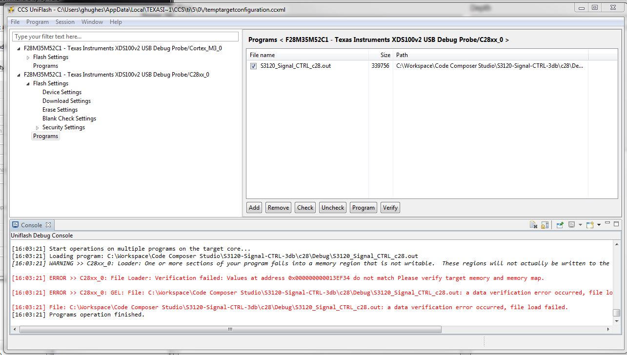

  • I went back and tried flashing with the Uniflash program and it does the samething as the CCS 6.1
  • Greg,
    Which version of UniFlash were you testing with?
    I've been actively looking into this problem, but unfortunately, I haven't been able to reproduce the problem yet. I am able to program my F28M35 device with CCS6.1 without any problems.
    Can you also share the program (.out file) you are loading?
    I will continue looking into this and report my findings.
    Ricky
  • I am using CCS UniFlash,  Version: 3.3.0.00053  and CCS  Version: 6.1.0.00104

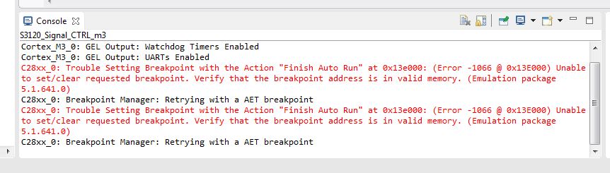

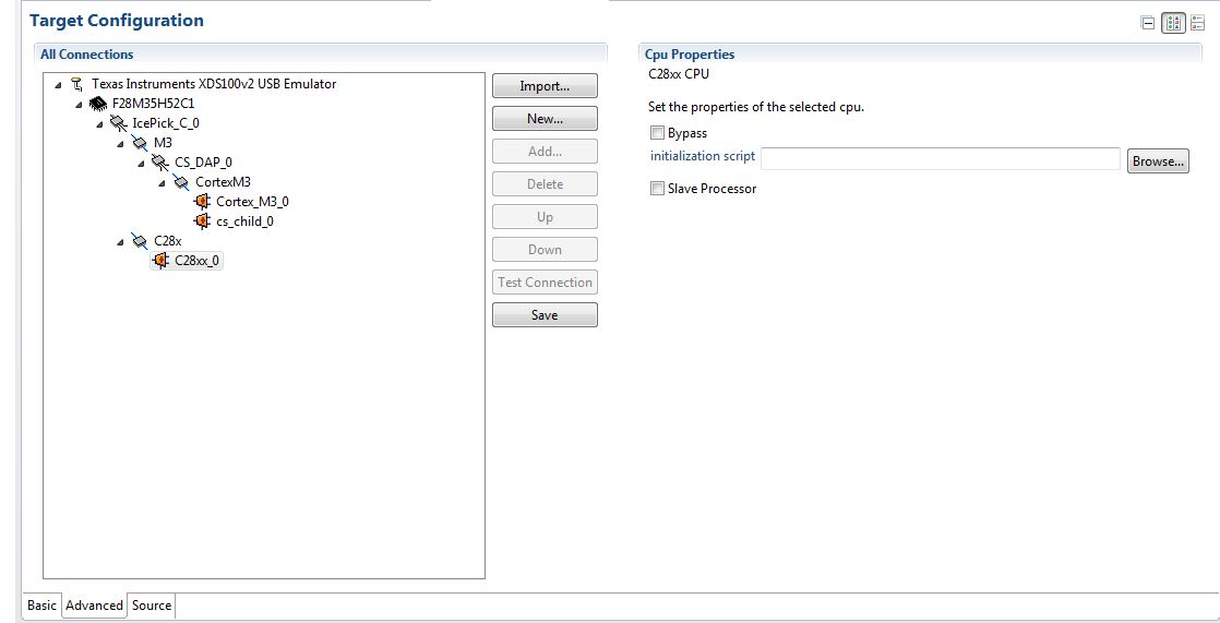

  • I tried the workaround from the other thread with some success.
    What I did...
    • open the Target Configuration
    • Select the advanced tab
    • Select the C28xx_0  and remove the initialization script totally
    • save
    The board did finally program with out the gel script..
    What is the purpose of the gel file??
    But now im having breakpoints errors, can't reset anymore
    thanks
    Greg
    Screenshots attached

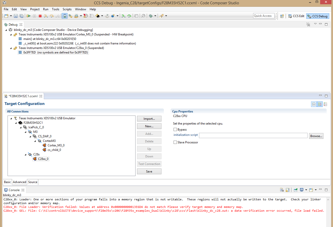

  • Hello Ricky
    Unfortunately I got the same error:

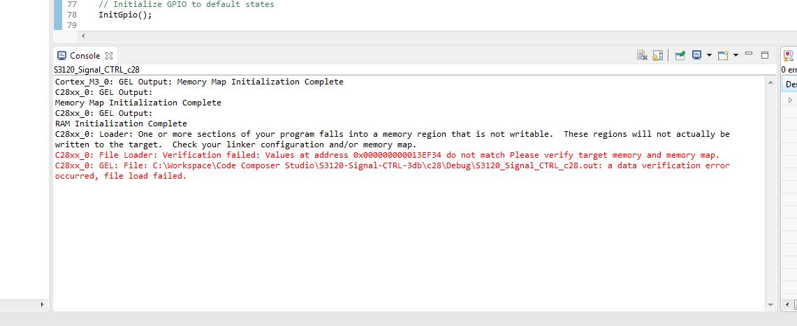

  • Hi Ricky,
    I finally had a chance to generate the logs. Attached is a log for a working flag, using CCS 6.01, and a failed flash, using 6.10.
    In both cases, I do a quick build (with no changes) and then a flash using a debug configuration that loads both cores.
    Other info you requested:
    1. Emulator XDS100v2
    2. OS: Windows 7
    I hope this helps.

  • Happy to see progress!  However, the new dll did not seem to help me at all.  I attached a debug server log.
    debuglog.txt
    --Nick

  • Hi Rick
    For some reason that I am not able to imagine, today It has been impossible to connect and to download any code into the C28.
    Attached I send the error message I get (again the same as at the beginning).
    I'll try to make the tests you suggest to me.
    Dionisio
  • Nick,
    Looking at the provided log, it looks like the original problem is fixed, but the log is showing that the error is "Could not open file". Can you make sure the program you are trying to load is available and accessible on my machine?
    Ricky
  • Oh look at that. When I'm not in a rush and pay attention to what I'm doing it works just fine with the latest DLL.

  • Now it works!
    Following the Ricky's advise, I checked out the .dll files in my compiler and I found two with similar name:
    6445.FlashC2000F021.dll
    FlashC2000F021.dll
    I deleted the latter and renamed the former to FlashC2000F021.dll and now it works.
    The problem came out when I downloaded the patched file because it came out with a wrong name: 6445.FlashC2000F021.dll, so the compiler was not using it and instead it was still using the old one.
    Thanks Ricky!
