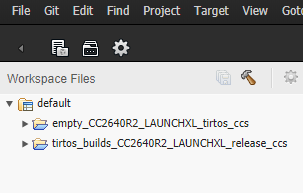

Are you using the latest SDK version (2.20)? In your screenshot, it looks like only the application project was imported, and not the dependent TI-RTOS project. Both projects should get imported when you import the empty project from Cloud Resource Explorer, as shown below:
Can you remove all project from your workspace and import the empty project again?
