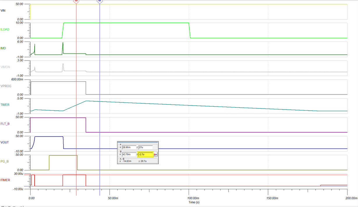

Tool/software: TINA-TI or Spice Models
Concerning:
* Part: TPS2492
* Date: 25AUG2011
* Model Type: TRANSIENT
* Simulator: TINA
* Simulator Version: 9.0.10.194 SF
* Model Version: Final 1.00
My simulation schematic is the slightly modified reference project.
1. TIMER discharge current is very low (30-900nA) instead of 2.7uA as expected.
2. The gate voltage, during the strong pull-down, falls to ground despite the Out being at 30V.
So the internal clamp does not work.
I hope you will find this notice useful at the nearest model revising.
As I find this model, as it is now, very useful - thank you very much for it.
Best regards
Robert
Here is my schematic I have simulated with Tina 9.3.150.4 SF-TI, downloaded from TI.
I have modified the Analysis Parameters in quite chaotic manner. Maybe this is the reason the simulation / model is not working well....
Robert
