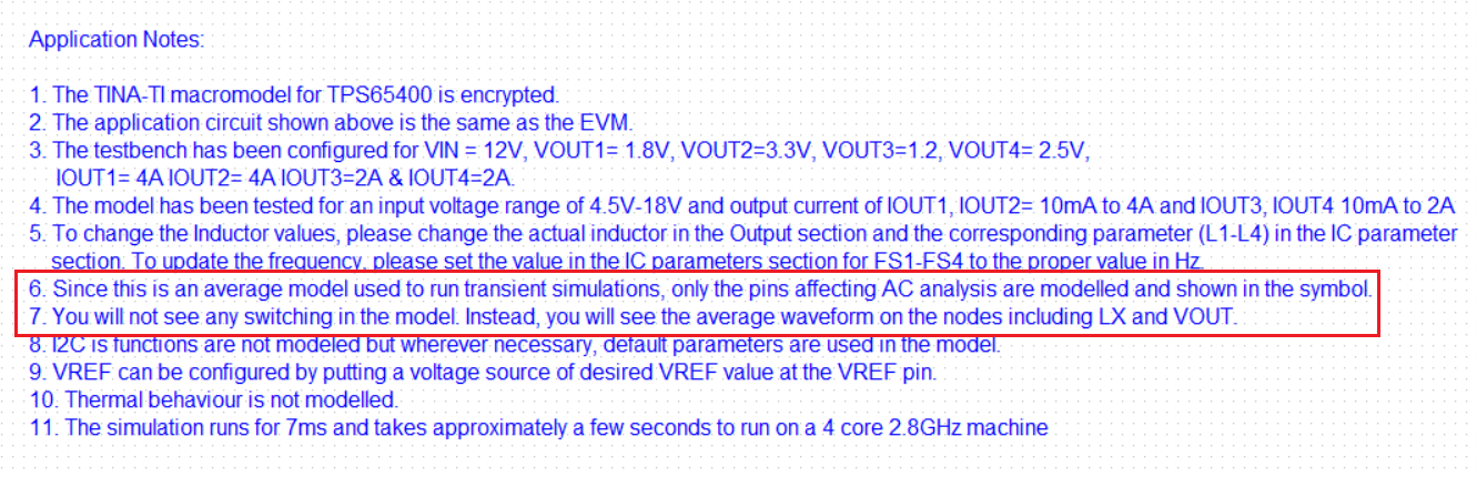

  • Hi, Dimitri
    1. Please note the "Application notes" in the TINA model: #6 and #7, see below.
    2. There is no unencrypted Spice-Model, suggest to apply for one EVM to optimize your design.

  • Hi, Dimitri
    I agree with what Pam said:
    "SPICE simulations may not capture efficiency accurately - especially the switching losses, reverse recovery losses etc. Typically the internal FETs and Drivers are not modeled to such level of accuracy. "
    This average model doesn't have switching, so it doesn't include switching loss, so we cannot use this average model to simulate efficiency.
    It think it is good to do the loop analysis(AC simulation) for compensation network.
    You can refer the efficiency @ "7.9 Typical Characteristics: System Efficiency" in datasheet for your application.
