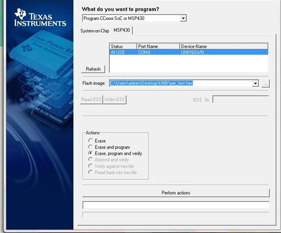

    However your question re version of the PER test got me thinking : To ensure that both are running of same PER test version,I tried to reload the ver.C of the PER test hex file using the flash programmer ver.1 and was only successful on one of the evaluation board. The other board's MS340 MCU seems not recognized i.e."  in use...device unknown" is being displayed.
    Please see attached picture. Any idea what is causing this?
    Thanks again,
    Ariel
