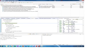

    here is the screenshot from where the return value is -2005
    The code exit after line218, when problem exist.
    executing the code in line 218 the error - 2005 is return on line 917 on driver.c file.
    When there is no problem RetVal = _SlDrvMsgReadCmdCtx(pCmdCtrl->Opcode, IsLockRequired); /* will free global lock */
    RetVal is 0 and sl_Close return 0.
    When there is a problem this line return -2005 and it  is returned from sl_Close
    Ilian

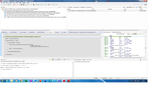

    More deeply:
    After line 917 , the code go to line 1878
    RetVal = _SlDrvMsgRead(&outMsgLen,&pAsyncBuf);
    enter here, after some SPI communication (may be there is a problem)
    this return -2005
    Ilian
  • It seems that it fails due to timeout waiting for the response  (the timeout is currently set to 50msec, see SYNC_PATTERN_TIMEOUT_IN_MSEC in driver.h).
    It looks like the sl_Send (in this mode) blocks other commands execution (including sl_Close and sl_Stop) and that it can't be canceled.
    You should either use a smaller packet count (in a loop on the host if needed) or extend the timeout.
    Br,
    Kobi
