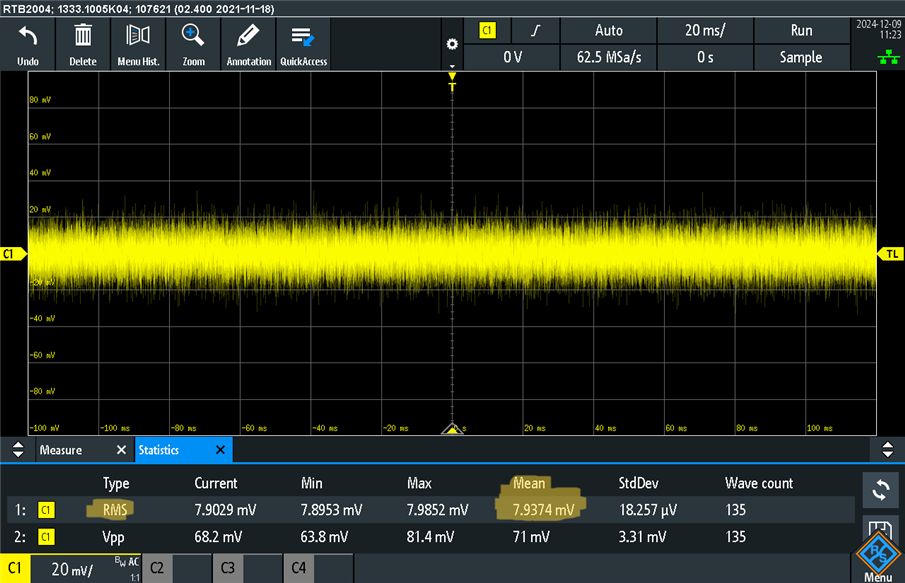

  • Dear ,
    Based on your amplifier circuit (see your second answer), I designed a PCB:
    - The three amplifiers stages are built using two OPA2375.
    - Vcc is generated by a generic 7805 linear regulator connected to a battery.
    - Vref = Vcc/2 is generated by TLE2426 connected to Vcc.
    - C5/C6 are 10 pF.
    When the input of the amplifier circuit is shorted, my scope sees this signal at the output of the circuit:
    With these settings, the scope measures/calculates an RMS value of about 8 mV.
    Also, this scope includes a "poor man's tool" to measure the frequency response of this circuit as follows:
    The gain (blue trace) is about 80 dB as simulated, however, gain rolls off faster (48 dB @ 1 MHz) as projected in the simulation (~ 70 dB @ 1 MHz). I assume this is because of C5/C6 being populated compared to the simulation.
    Can I work with this? Any comments or suggestions for improvement are welcome.
    Thanks.
    Daniel
    PS: Edited...
  • Daniel,
    C5 and C6 can lower the bandwidth. That can be good or bad depending on the application requirements.
    For a comparison you can also check the scope noise with the amplifier power off. The noise may be similar with power off. In other words some of the noise may be from the oscilloscope itself. Another check is scope shorted input noise.
  • Hello ,
    with the amplifier connected to the oscilloscope but powered off, the RMS value reads 1.4 mV and I see a small 50 Hz periodic signal. With the input of the oscilloscope shorted (with a 50 Ohm resistor), I see no signal and the RMS value is as low as 40 uV.
    So I guess the difference of 6.4 mV (between the 8 mV RMS of the powered amplifier and the 1.4 mV of the unpowered amplifier) is the noise that the amplifier generates without any input.
    The gain of the amplifier circuit is 10000 V/A. Then can we say that a noise of about 6,4 mV RMS is equivalent to an input referred current noise of ~ 0.6 uA?  If that calculation is correct and in light of the noise I'd like to measure (3 uArms, see first posting, and the reference current source of 2 uArms noise) would this qualify this amplifier circuit for this measurement task?
    Thanks.
    Daniel
  • Daniel,
    The power off test and short scope test was just to gauge the noise measurement ability. You can RMS subtract the 50 ohm scope of 40uV but that is quite insignificant.
    8mV / (10kV/A) = 80uA.  This is clearly too much noise. You can increase gain by increasing shunt resistor; this is a direct improvement. Four times the resistance lowers input refereed noise to 1/4.  You can reduce the resistors in the amplifier (remember almost all the noise comes form the resistors) cutting resistance to 1/4 drops the input noise to 1/2 (result is square root of change).  I suggest increasing shunt as far as practical then lower amplifier resistors.
    The measure noise needs to be lower than 1/2 of the signal noise. This gives a S/N power ratio greeter than 4. Easier to correct for measurement noise.
    FYI: The resistor voltage noise formula E=√4⋅R⋅k⋅T⋅ΔF
  • Hello ,
    Thank you for your reply and thanks for reminding me not to simply subtract RMS values directly but to add squares and sqrt them.
    Regarding your calculation
    Sorry, I can not say that I understand your calculation. How did you get to the 80 uA? I calculated this the other way round, starting at the input of the circuit: an input current of 0.8 uA through the sense resistor of 10 Ohms will generate a voltage of 8 uV across the resistor. This will be amplified (by three 10x amplifier stages) by 1000x , thus giving an output voltage of 8 mV. So 8 mV (noise) at the output should be equivalent to 0.8 uA and not 80 uA. I'm at a loss. Please help.
    Regarding reducing noise, if most of the noise stems from resistors, using lower resistance values for the feedback network could help reduce noise. So why did you not suggest 1k/10k for setting amplification in the first place (but 10k/100k instead)? I guess there's a trade-off. What other other factors are to consider when using lower resistance values for the feedback network?
    I'm learning a lot here. Thank you.
    Daniel
  • Daniel,
    You are right 0.8uA ; that is much better. I really shouldn't do the math in my head.  Slight smile
    I picked 10k instead of 1k, because I didn't want to have to consider the frequency variable load on the 10 ohm shunt resistor. Noise wise, the first stage is most important. So I didn't consider, changing the values for the later amplifiers.
    So reducing 1st amplifier resistors by 10X and increasing cap to 100uF. will keep the same lower cutoff frequency. Going from 0.1% load (10k vs 10) to 1k changes to 1% load is roughly a 1% loss in total gain, not an issue. Estimated noise reduction is sqare_root(10) * 90% = 2.85 times, so 0.8uA to 0.28uA.
    Why 90% for 1st stage? If each stage has noise of x ; total noise is 100x + 10x + x = 111x ; 100x/111x = 90%
    You could change all the stages but probably not worth going to such a big capacitor.
