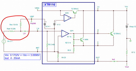

Now simulation is working fine with the given voltages of Vin: 0.1752V - 3.0998V ----  Iout: 4 - 20mA .
I have ordered XTR116 convertor module for the prototype, the block diagram is shown below.
The application is given below in block diagram.
I had tried this by using this convertor module and 2 wire current loop, and i have powered up The MCU  and other given ckt by XTR116 5V regulator output, and i got output prints from RS485 on Terminal window. (Very less current required for device to print the output)
And i manage to provide the voltage from DAC to XTR116 convertor to check 4 to 20 mA for DAC voltage 0.1752V - 3.0998V respectively.
The resistors provided by last case i had mounted on the convertor board but still the value at lower voltage not getting proper. from  1.4884 to 2.95271V it gives proper current output as shown below.

3.09981 10.89
So the expected current output for 0.172502V is 4mA but when i start power supply the starting current shown on DMM is 10.89mA and it varies slowly and when i apply voltage in the sequence above in the table it gives the reading correct after 1.4884 to 2.95271V, why this is happened.

    I was talking about Ros and Rset resistors in simulation, I managed to set these resistors value on Development board, I have changed the R3 as 18.26K ohm Resistor and the Junction of the same connected to Pin 1 of IC (Vref) via 134.5K Ohm.  As shown in below image,

    This looks like a classic example of limitations being caused by the external circuitry consuming too much current. As described in the 2-Wire 4-20mA Sensor Transmitters: Sensor and Transmitter Current Consumption Limitations post, when you have over 3.8mA of current consumed by circuitry being powered by the VREG and/or VREF pins.
    This theory also explains why the simulation didn't see it as you didn't add the input to the XTR in the simulation!
    Next steps would be to confirm the quiescent current of your input circuitry and see if it consumes more than 3.8mA. Based on the fact that your circuit can't go below 10-11mA, I would suspect it might be consuming around 14mA.
