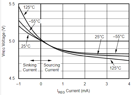

  • Figure 5-4 shows that the regulation is quite bad even for small currents:
    This is why I have recommended a constant-current source.

  • Hi Zabbza,
    The maximum current that the VREG can supply is shown in it's short-circuit current, which shows a typical value of 12mA.
    However, we only characterized the VReg voltage in relation to Ireg current up to 4mA.
    Since this is a 2 wire loop you want to avoid having the XTR117 and devices being powered by Vreg to consume over about 3.8mA of current. This is due to the current loop for the signal also being used to power the XTR117 and the other devices. If they require more than 4mA of current to operate, then your current loop can't go down to the minimum current.
