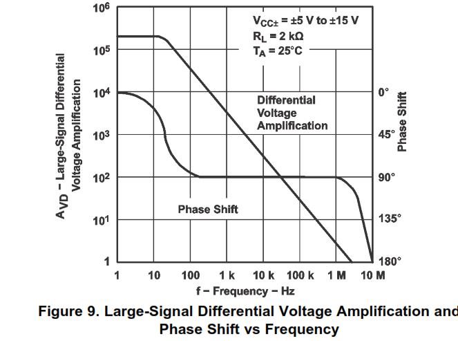

    I'm sure what you're asking for with all the current limit and extra resistor questions, but I'll add some additional information that may be helpful.  When the output is saturated you'll see the 200 Ohms of output impedance that was calculated in the posts you linked to originally.
    When the op amp is operating in a linear condition the open-loop gain (Aol) of the amplifier is very large at low frequencies.  In a linear operating condition the closed-loop output impedance (Zout) presented to the load will equal the open-loop output impedance (Zo) divided by 1 + Aol*B, where B (Beta) is the feedback factor and Aol*B is the "Loop-Gain".  So for frequencies where the loop-gain is large the closed loop output impedance (Zout) will be small.  Lets take an example at 10Hz assuming the open-loop output impedance (Zo) is roughly 200 Ohms and the op-amp is configured in a unity-gain configuration so the loop-gain (Aol*B) is equal to Aol. Since Zout = Zo / 1+Aol*B we can solve for the closed-loop output impedance at 10Hz as shown:
    Zout = Zo / (1+Aol*B) = 200 / (1 + 200,000V/V) = 999uOhms (9.99E-4 Ohms).
