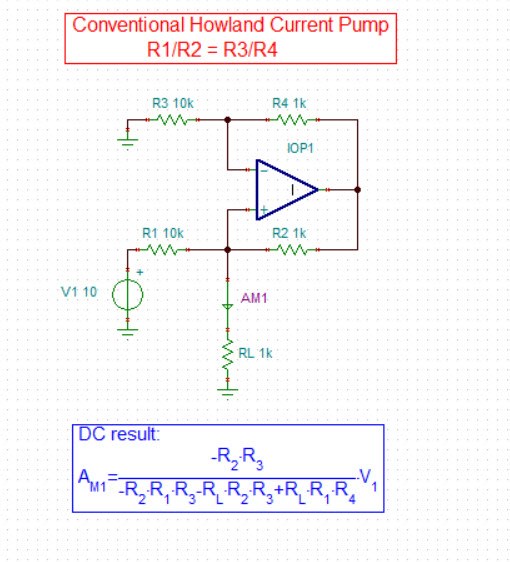

    I will restate my question in another way. Please find the attached image of Howland current pump.
    I removed the signs of the opamp.
    My question is I need to determine the signs of the opamp such that the system works in negative feedback.
    hari
  • Hello Hari,
    I am not sure that an analysis that doesn't include the operational amplifier input signs makes sense. You wouldn't know if the output is inverted, or in the same phase as the input, which is important to know with regard to negative or positive feedback.
    I show below the transfer function for the conventional Howland Current Pump and you will note that there are minus signs in the equation. That indicates that sense of the feedback has been taken into account.

    May I know how to determine the signs for figure 10
    Hari
  • Hello Hari,
    Actually, the author provides the solution for the circuit shown in Figure 10 on pages 4 and 5:
    "In fig(10),there are two opamps. First we have to determine the signs of one opamp assuming all other opamps are ideal. Let opamp(1),assuming opamp(2) as ideal, then:
    Vid1 = −Vo1(R3 R4) [R1 / (R1+R2)]
    So we connect this to positive terminal. Now we know the signs of opamp(1). To dermine the signs of opamp(2),
    Vo1 = Ao(Vo2) [ R1 / (R1+R2)]
    Vid,2 = Vo1 [R3 / (R3+R4)] + Vo2 [R3 / (R3+R4)]
    So we connect this to negative terminal of the opamp(2)."
