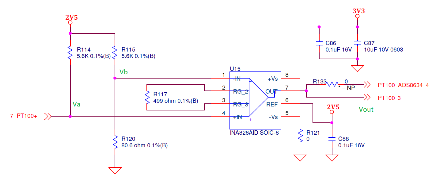

About the INA826 with the single power supply application as following circuit.
If using single supply, REF 2.5V is needed, correct ?

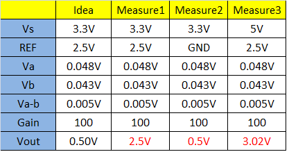

Why is the wrong Vout by the measure 1 & 3 ? Vout is corrct with measure 2, but REF is connect to GND ? Could you please help to check for this ? Thank you.
Jackson,

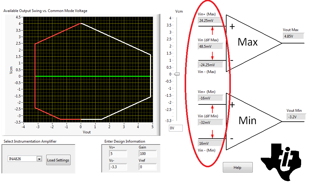

Based on R115 of 5.6k, 80.6ohm R120 and 2.5V shown on your schematic, the nominal value for Vb is NOT 43mV but rather 80.6/56,080.6*2.5V = 35.8mV. Thus, according to Vout vs Vcm plots shown above, Vb will be outside of the linear input range for REF=0 and REF=2.5V resulting in the Vout collapsing on its positive rail.
Hi Marek Lis, Kai

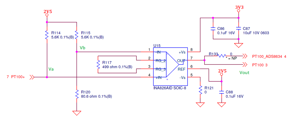

Thanks for your feedback. I modified the schematic( Vs=5V, -Vs=-3.3V) to meet the request as below. Could you please help to double check everything if ok ? Thank you.
-Resistance of the pt100 around 80.77ohm~154.11 ohm
-Vdiff around 0.043mV~31.38mV
-Vout around 4.33mV~3.14V
