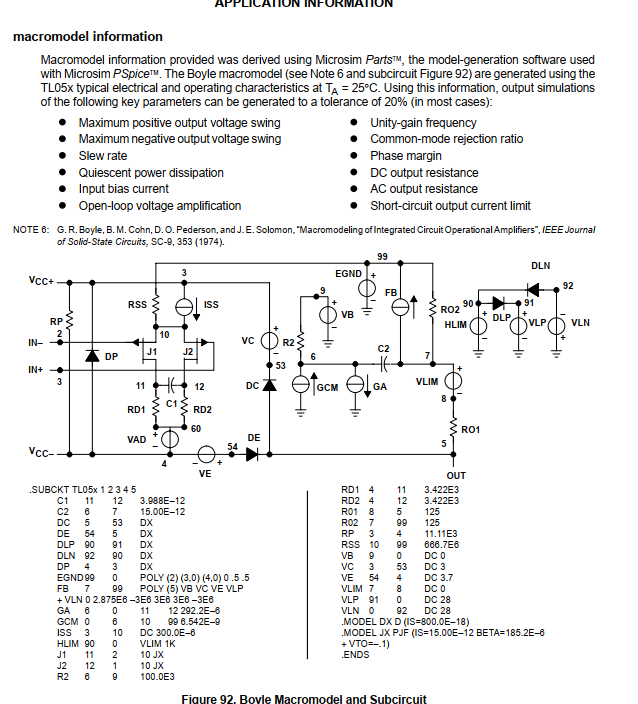

  • Can I bug you for one more thing?
    Attempting to modify the model ....
    Please provide a schematic of the pspice model posted.
    OPA541 OPERATIONAL AMPLIFIER "MACROMODEL" SUBCIRCUIT

  • Hi Tim,
    I think we have here the "Bolye Macromodel and Subcircuit". Figure 92 of datasheet of TL054 shows it, for instance:
    The given values are only valid for the TL054, of course!
    Kai
