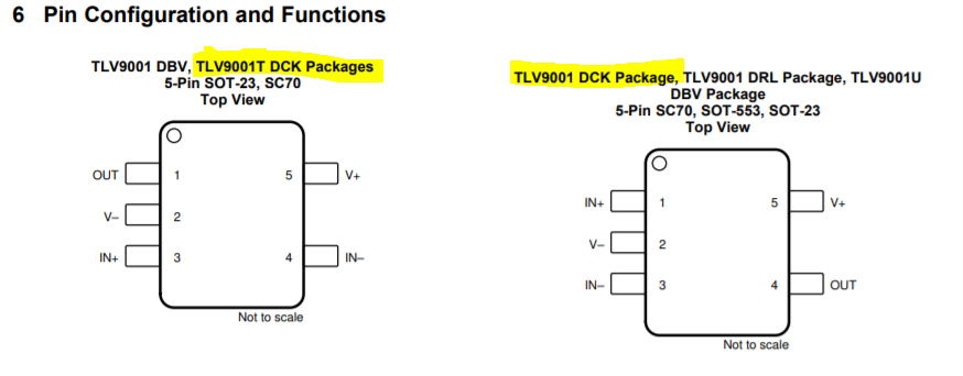

TLV9001: What's different between TLV9001TIDCKR and TLV9001IDCKR?
Part Number: TLV9001
Dear team,
May I know the different between TLV9001TIDCKR  and TLV9001IDCKR?
Ben
