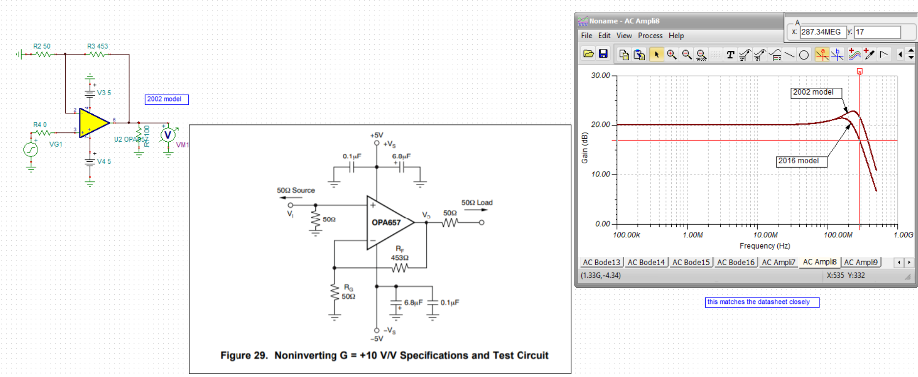

  • Went a little further with OPA657 model testing.
    While the 2002 Aol curve looks like it matches Figure 16 in the datasheet closer, the closed loop gain of 10V/V in figure 1 looks to be matched better by the 2016 update, not sure what to say on this one at this point,
    and with the 2002 model response overlayed,

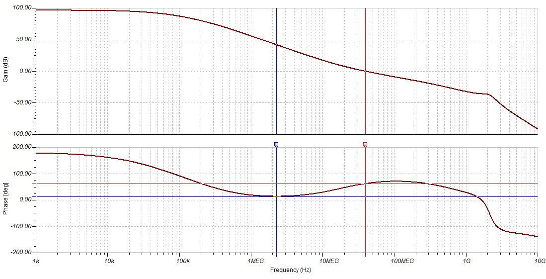

    Thanks to your help i was able to calculate suitable values for the feedback path of my TIA (see files attached). In my phase plot (open loop) i can see a phase margin of approx. 62 degree at unity gain which is perfectly stable. However at lower frequencies (~2,3MHz) the phase margin is only 14 degrees. Does this mean the circuit is instable? A transient simulation (closed loop) with a frequency of 2,3MHz does look good and the overshoot is not extensively high, but why? The phase margin is very low at this frequency.
    tia_open_loop.TSC
    tia_closed_loop.TSC
  • What you are interested in is actually the 1/(1+1/LG). Where the lower F phase is pushing towards 180deg that makes negative result for the 1/LG - but since the LG is very high there, it is a small negative number adding to the 1 term - no problem. up where the LG is close to 0dB (or 1) then a 180 phase around the loop will be a 1/(1-1) and it blows up - hence instabilty.
  • Ok. So if i got that right my circuit is stable because at unity gain the phase margin is greater then 45° and even if this margin is less for lower frequencies i've got not problem there because of the limited effect to the loop gain?
