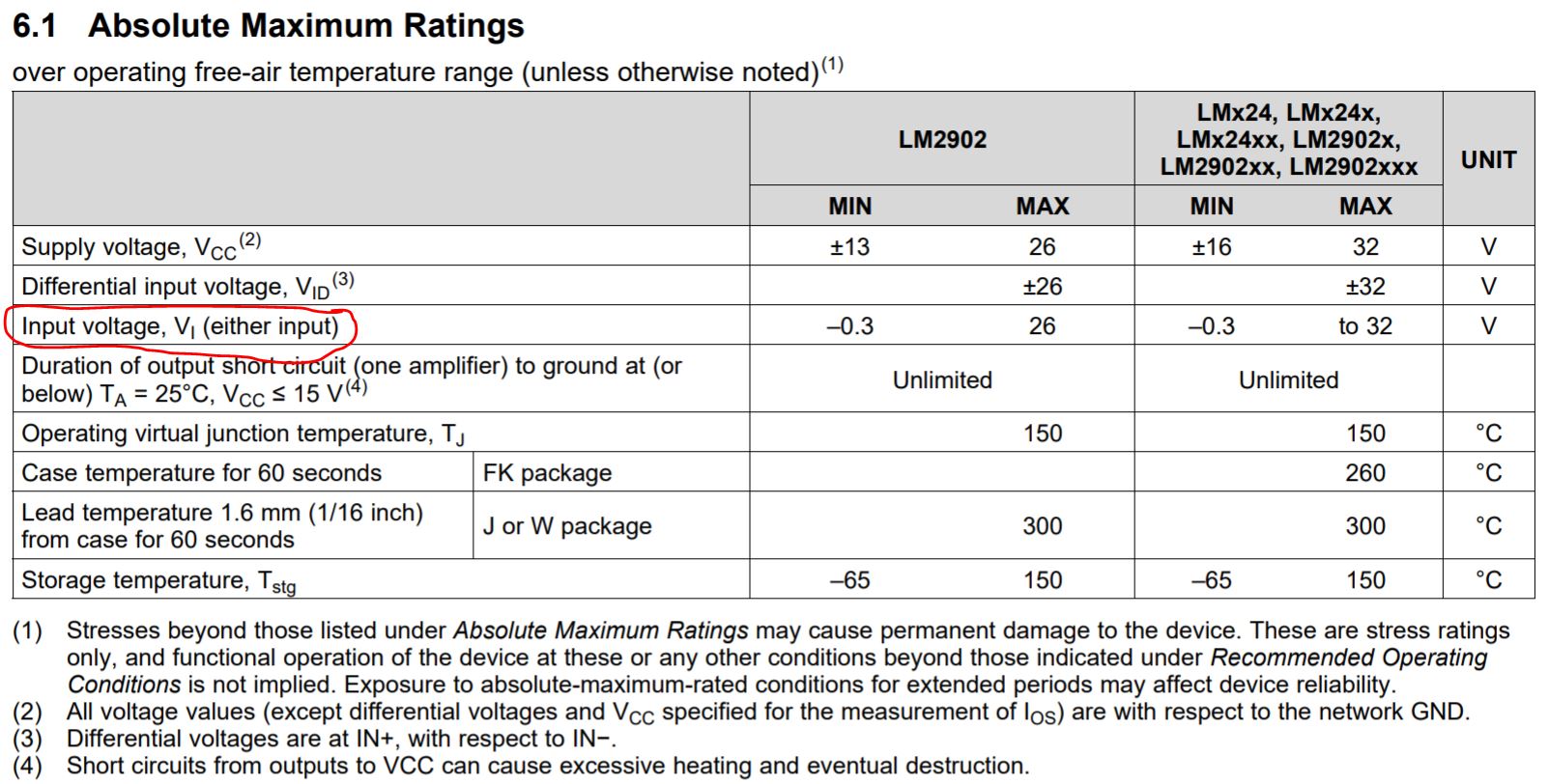

Hi Team,
Customer wants to know whether below maximum rating for input voltage(VI) is related to supply voltage (single rail or dual rail)?
In our datasheet, the maximum rating of VI is -0.3 to 32V. Does this apply for all conditions? If not, how this value is estimated with supply voltage? You can check below screenshot for reference.
