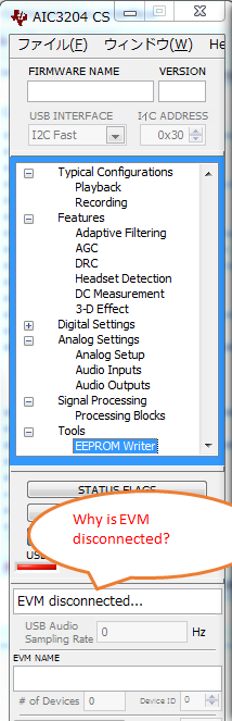

I do not know why this happened.It's always disconnection.
How to restore TLV320AIC3204EVM-K  to  the original state.
  • Hi, Zou,
    It seems that the firmware of the EVM you were using is corrupt. Please refer to the information on this wiki entry and follow the steps to revive your EVM.
