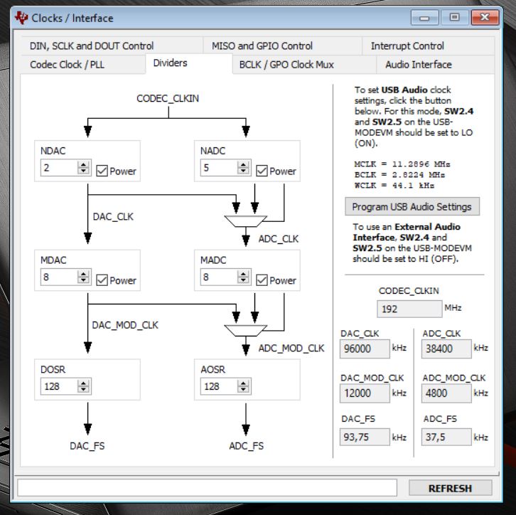

    However, I am still confused regarding the PLL setting in the software. Here I give you the pictures of my current setting
    If I use PLL, I have to set SW2-4 and SW2-5 to LO (ON) because I use USB Audio clock (according to the second picture). However, this setting is exactly the opposite of what you said. So which one should I use?
    Furthermore, if I use MCLK and BCLK from external source, can I use these two clocks as the input of PLL? (It seems that I have to define it like the first picture)

    You said you were hooking this up to an STM32F446ME, and your clocks were connected directly (your pictures)
    This is exactly what I said.  SW2.4 and SW2.5 should be set to "HI" or off
    Regarding the PLL configuration,  my apologies,  I thought the AIC3204-CS software had the PLL configuration tool.  but it appears to be for the AIC3254-CS
    if you download the AIC3254-CS software you can still use this tool:
    This will take into account all of the PLL and Clocking constraints.

  • Hello Steve Wilson!
    Yes, that's what I need to understand. So if I want to use external clock, the SW2.4 and SW2.5 should be set to "HI" or off, and for internal clock is vice versa.
    Anyway, thanks for your help! Now I can collect some data from my analog sensor. However, the sampling frequency is still not as I expected. I might need to do some fine tuning for this issue. I'll let you know once I have another question.
