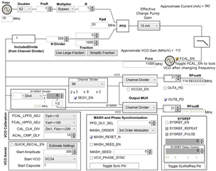

The chart below shows the frequency variation from 50-100Mhz and a 20us delay.

    1. I've tested it in the range of 11900 MHz to 12100 MHz,The output be muted, time is still 20ms.
    2.Sorry,Are you writing wrong? The mute output should be OUT_FORCE = 0 and OUT_MUTE = 1;
    3. I've tested an experiment,The output be muted, time is still 20ms.

    What is the green trace in your plot? From the plot, the mute time should be 20µs not 20ms.
  • Hi Fung,
    Does the green trace refer to my reply on June 22? That line is the trigger signal for writing the R0 register,Pull up before writing R0 and pull down after writing. such as in my code TP_ H is Pull up, TP_ L is Drop down.
    Yellow is the output frequency. In the oscilloscope window, each grid is 10us, and there is no frequency in the middle. The time of two grids is just 20us.
    So the mute time is 20µs.
