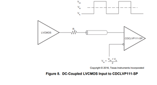

Intent to drive CDCLVP111 with a +1.8V LVCMOS oscillator. The question is if the negative input of CDCLVP111 is set to 0.9V (1.8V/2) as the threshold voltage and the oscillator is connected to the positive input, is it violating the required minimum Vcm voltage of 1V?

The oscillator is a +1.8V LVCMOS so we can assume VIH = 1.8V and VIL = 0 and Vth would be set to 0.9V, 1/2VCC.

Yes, I am using 1.8V supply. If the Vth is 0.9V, the VID would also be 0.9v which satisfies the requirement. My question was what about the Vcm? Is there an issue with Vth being 0.9V.

Let me be clear: the power supply for CDCLVP111 is +2.5V but the oscillator is +1.8V.

Hello Chong Kim,
The Vcm should be set based on CDCLVP111 Vcc not Oscillator Vcc. If you are trying to utilize 0.9V (1.8V/2) of Vcm this does not meet requirements.
The 0.9V is for Vth, not for Vcm. The question was how to interface a +1.8V LVCMOS signal to CDCLVP111? Aside from setting Vth = 0.9V, are there any other issues that need to concerned with? Does Vcm even matter for interfacing a LVCMOS signal to CDCLVP111?

The VCM must be within the specified datasheet range when the inputs are DC coupled. You'd have to change the external biasing circuitry to match the datasheet requirements. If the inputs are AC coupled, then the VCM does not matter.

VTH needs to be at least 1V to meet part requirements. Using 0.9V would not appropriate for your design.
