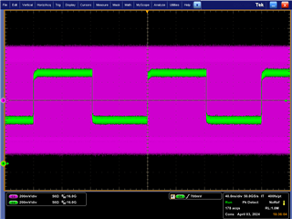

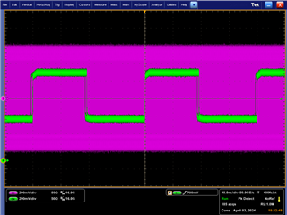

  • Hi Bjoern,
    I have some test data.
    Are you seeing below RFout vs SYSref out timing issues in repeater mode?
    Top traces came from EVM#1 and the bottom traces came from EVM#2.
    Sometime both SYSref out are aligned.
    I believe it is because the sysref is reclocked, so the reclocking circuit keeps tracking the signal and created jitter to sysref output.
    Below is the zoom in, we can see the output sysref is not stable at all.
    I also checked this on LMX2820, it has the same issue with synced repeater mode, but not in no-sync repeater mode.
    Synced repeater mode:
  • Hi Noel,
    yes my initial findings were the pretty much the same:
    My observation now is that with at least two of the above setups (2.0 GHz and 2.5 GHz RefOutA) the RefOutB outputs of these two LMX2572 are not always aligned, but simetimes are two RefOutA periods apart.
    I was observing PLL1 and PLL2 either being alligned, or PLL1 and PLL2 being two clocks apart, whilst in your measurements/scope picture you see them alligned or observe four clocks apart.
    But my guess is that this is depending on a different f(interpolator). In my 2GHz RFoutA case, my f(Interpolator) was 1 GHz, with f(VCO) = 2 GHz. My feeling is, that re-clocking to f(Interpolator) with a ratio of 1:2 compared to RFoutA is hence causing the SysRefOut ambuguitiy of 2 RFoutA clock cycles. Could it be that with your setup, you have had a ratio of 1:4 hence observing an ambiguity of 4 RFoutA clocks ?
    So just to make our both findings absolutely clear to me, is it correct so say :
    1. That the LMX2572 is not providing a deterministic SysrefOut in relation to the input SysRefReq, even when fully complying to the stated setup/hold timing for the SysRefRequest pin ?
      And the reason for this is the internal, non-bypassable, re-clocking of the SysrefReq input, from
      1. Ck(OSCIn) to Ck(Interpolator)
      2. Ck(Interpolator) to Ck(RFoutA)
    2. And the same applies to LMX2820 when its re-clocking is active ?

  • Hi Bjoern,
    I think so, I verified this in LMX2820. SYSREF_DIV_PRE will affect the number of clock cycle offset in sysref repeater synced mode. In non-sysc mode, SYSREF_DIV_PRE has no effect and the sysref output are always phase aligned.
    I am checking with the design to see if there is a way to make sysref output phase aligned in synced mode.

  • Hi Bjoern,
    Apologies, I forgot to get back to you on this.
    There is no way to bypass the reclocking in repeater mode in LMX2572. I think you have to feed the sysref signal directly to the ADC.
    another solution is, instead of using multiple LMX2572, could you use one LMX2572 + LMX1204 to fan out 4 RF clocks and 4 SYSREF clock?
    LMX1204 supports SYSREF repeater mode (no reclocking).

  • Hi Bjoern,
    Right, LMX2572 and LMX2594 has the same characteristic.
