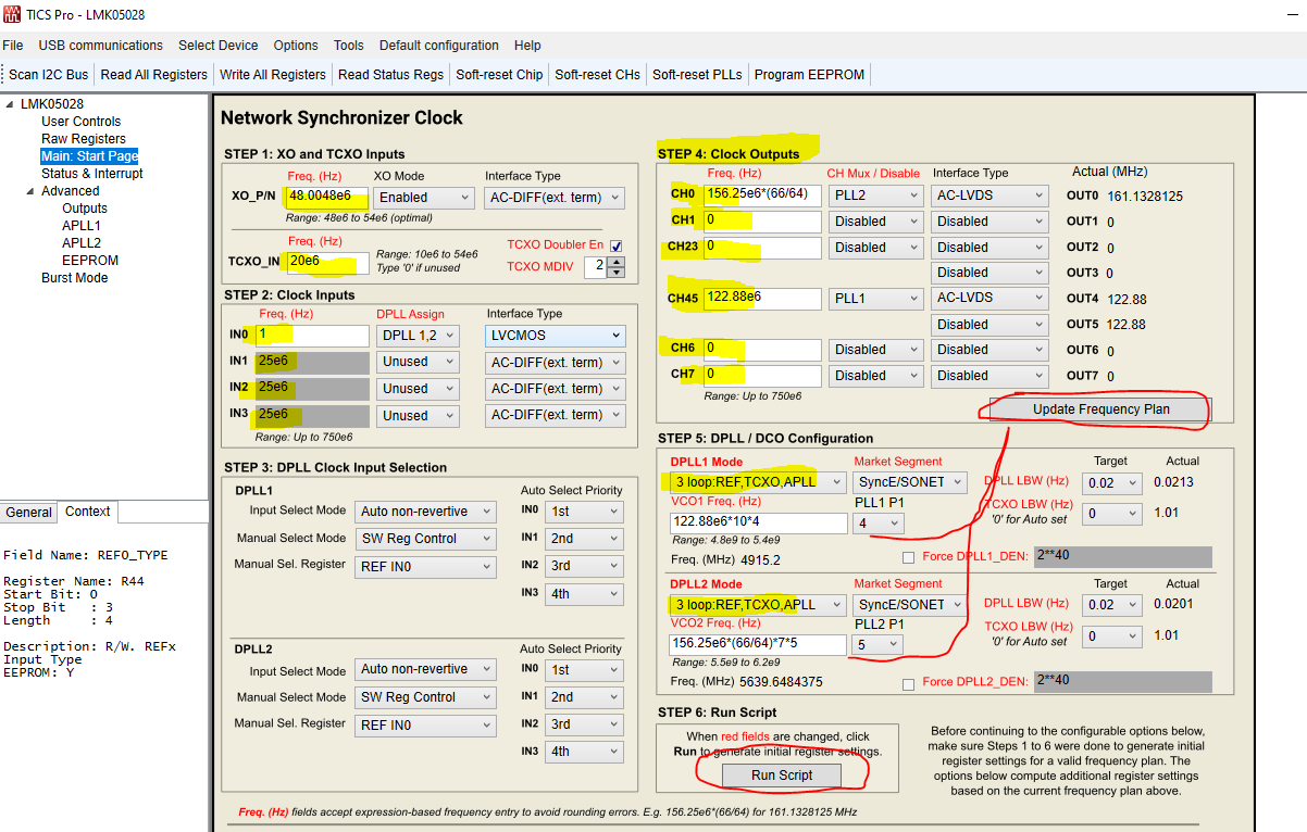

I am currently using the LMK05028EVM with 1Hz PPS input to generate 122.88MHz output (with an 20MHz OCXO 50ppb stability). We are having an hard time getting a good phase and frequency lock on DPLL1/2. I can see that the duty cycle on the 1Hz input make a big difference on how easily the REF-DPLL can lock.
What values should i use into DPLL Frequency and phase lock detectors for 1Hz input?
Please find attached the TICS pro configuration file for reference.
Thanks.
LMK05028.tcs

  • Here are my recommendation steps for locking 1 pps - note I don't think the flag indicators are the best way to do this:
    1. Start with EVM default configuration - menu option: Default configuration --> EVM default
    2. Provide inputs in steps 1 - 6 as need and then perform a runscript
    3. Post runscript perform a status readback: Is reference valid? Is reference selected?
    4. Monitor R divider and N divider path on stat0 and stat1 - are the signals aligned or 180 phase shifted? Are they approaching that position
    • Once aligned you can be certain DPLL is locked
    Frequency detectors should not need any adjustment. My experience has been frequency detector works as anticipated from what runscript provides.
    Phase detector will need adjustment, hence monitoring Rdiv and Ndiv to confirm lock and not depend on status flags that by adjusting these counters could easily be misleading. Once you can observe Rdiv/Ndiv are aligned (or 180 phase shifted) increase phase detector until flag corresponds - this usually involves increasing until ~ 5.5+ ns for lock threshold and ~1.5+ ns for unlock threshold.
    I would advise a few soft resets and proper waits to observe behavior of both the flags as well as actual Rdiv/Ndiv alignment.
    Thanks and regards,
    Amin

  • Hi Cyril,
    Just confirming we're on the same page... the "Validate PPS input but still can't get frequency/phase lock with default setting from EVM" comment through me off.
    So EVM default configuration is not for a 1 PPS input - it is for 25 MHz. The reason I asked you to start there is because not all registers update after a runscript, so in order to avoid any bad starting point or bad register configruation, it's good to start there AND then make changes and needed.
    The picture of the Main:Start page is at the bottom of this post - after loading EVM default, make changes in steps 1-6 as needed and then do runscript. Then try all the debug steps I've suggested above after script is run and the registers are updated per your specific inputs.
    Thanks and regards,
    Amin
