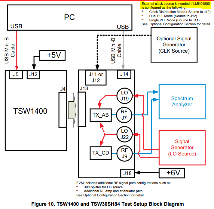

I am trying to run the Texas Instrument test file single tone complex test file with my setup which is a TSW30SH84EVM and TSW1400 and I am not getting any signal coming out. I really don't understand what I am doing wrong because I am able to run all of the WCDMA test files, I believe it has something to do with two column data that I'm missing in the settings of the TSW30SH84EVM or the TSW1400. Any help would be greatly appreciated. Attached  is the TI test file path I'm talking about:
"C:\High Speed Data Converter Pro\Test Files\single_tone_cmplx_32768_250MSPS__BW_25.1MHZ.csv"

  • Hi Joshua,
    I'm sorry for the misunderstanding! Looking at the TSW30SH84EVM user's guide, this kind of operation is not possible using only the LMK. Please read the note in the upper right hand corner of the image below. I am checking to see if Single PLL mode will work while utilizing an on-board crystal oscillator (jumper modification). This information is located in the Optional Configuration Section of the user's guide.
    The signal that goes to J19 is for the TRF3705 RF modulator, and basically "mixes" the output from the DAC with the frequency from J19. The TRF is independent of the DAC, so this signal has no influence on the data rate between the TSW1400 and the DAC. If you look at the power point I made, this explains why the spectrum analyzer shows the DAC output (30 MHz signal generated from data sent by the TSW1400) with an offset of 1780 MHz (frequency of signal at J19).
    I will need to verify in the lab, but I believe you can use just the external reference for the DAC (J12) and not the TRF LO signal (J19). However, if this is how you intend to use the device, I would suggest proceeding with the DAC34SH84EVM since it doesn't have the TRF3705 section. Do you currently have the TSW30SH84EVM in your possession?
