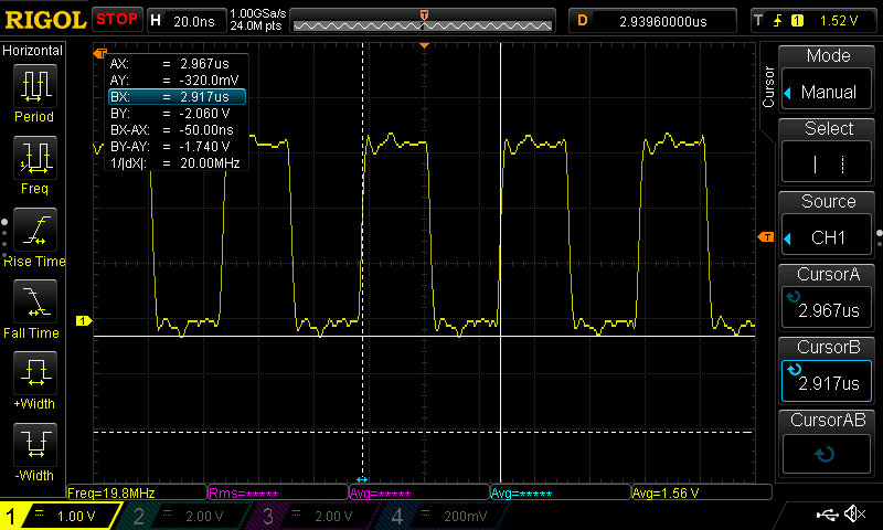

This is the 1Y output of AM26C31Q with VCC 3.3V. There is a 120 Ohm termination resistor at the receiver's input.
This signal looks fine.
Try again at the highest temperature you actually need to support. And as I said, there is no guarantee.

Please note that the receiver threshold is about 200mV. Even the output voltage with a 3.3V supply doesn't meet the RS-422 standard. The system might still work. However like Clemens said, TI doesn't guarantee the performance with 3.3V.
