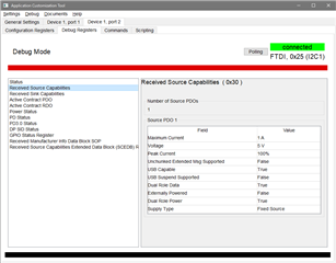

I set source PDO "5V 3A" of TypeC2 side. but I read Active Contract PDO " 5V 0.9A".
I have questions about Application Customization Tool  for TPS65988.
When I read Debug Registers, we can get Received Sink and Source Capabilities of "Device1 port1" by Polling.
But I cannot get Received Sink and Source Capabilities of "Device1 port2" by Polling.
Might be Active Contract PDO 0.9A.
So I try "Get Sink and Source Capabilities" commands, then I can get Received Sink and Source Capabilities of "Device1 port2".
 But Active Contract PDO 0.9A.
Why we cannot get Received Sink and Source Capabilities of "Device1 port2" by Polling at first?
How to charge 5V 3A ?

    Your application is in Dead Batter mode, where PD is powered from Type-C 1; in this mode, we limit the output capacity on the second port, and only 5V/ 0.9A source PDO is permitted.
    Do you have an MCU on your system? We may need that to help clear Dead Battery flag.

    I have a question. Do the first port(TypeC-1 sink) limit input capacity in Dead Battery mode ?
    My system have an MCU but I use PD controller in MCU power OFF mode.
    My system is connecting a input GPIO to the TPS65988 for detecting VBUS power supply.
    Could you tell me How to clear Dead Battery flag using GPIO ?

    No, sink port won't be limited, only the source port will be limited to output power in Dead Battery mode.
    We don't map Dead Battery clear feature on any GPIO. Thus I recommend that you should power on MCU after sink port have connected to a power source, then use MCU to clear PD's Dead Battery flag by using 4CC command "DBfg" to PD through I2C.
