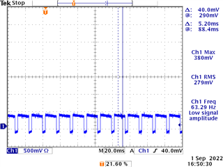

DN1_REFCLKO: No activity
DN2_DPSTRAP = 3.3V
GPIO[4] = 426 mV (4.7K Resistor)
GPIO[5] = 0V
GPIO[6] = 3.3V

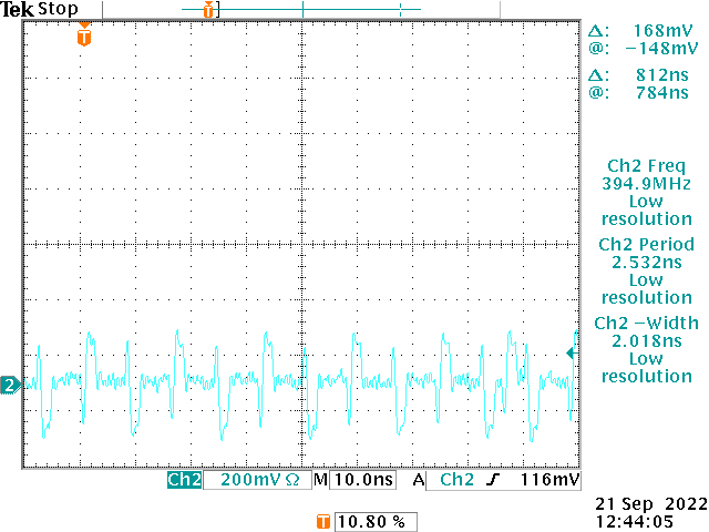

DN2_REFCLKO: 100 MHz clock
DN3_DPSTRAP = 0V
GPIO[8] = 3.3V
DN3_REFCLKO: 100 MHz clock

    So the question is, why isn't DN1_REFCLK0 outputting a reference clock?  Is it possible to swap the device on Port 1 and the device on Port 2 to see if this is device-related?  It could be that one of the devices is in a low-power state and is not requesting a reference clock.

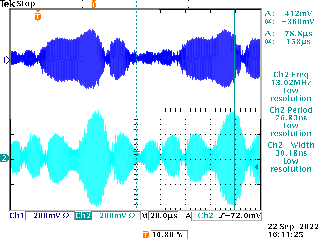

    What curious is that although Port 3 is disabled, there is activity on the DN3_REFCLKO signals.

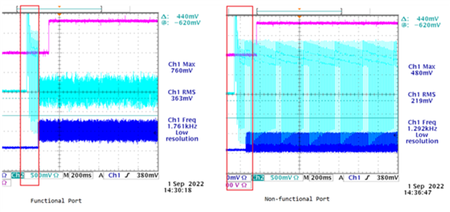

  • A bit more information:
    Dumping the PCI Config Space of the 3 downstream ports may provide a clue as to the problem:
    Port 1 Register 0x9A reports a "Correctable Error Detected", but I do not have the details of the error source.
    I can provide the contents of the register dump if it would be helpful (I am trying not to overload the thread with information Slight smile)...

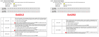

    PCI_D4h         0x00004292     0x00004290     0x00000011 General Control

    5. Register differences (not an exhaustive list):
       a. TI Proprietary register at PCI address D4h
          - Spec says it should be 0000 0010h, we read 0000 4290h
       b. TI Proprietary register at PCI address DCh
          - Spec says it should be 0000 0002h, we read 0000 0000h
       c. Downstream Ports Link PM Latency Register (PCI Offset E8h)
          - Spec says default is 3F24h, we read 0000h
       d. Global Switch Control Register (PCI Offset EAh)
          - Spec says default is 0004h, we read 0000h

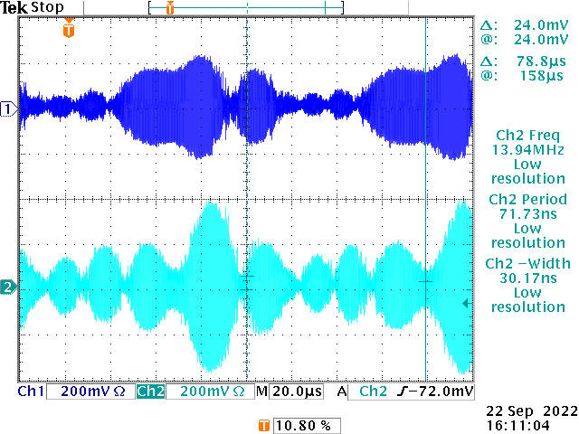

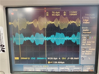

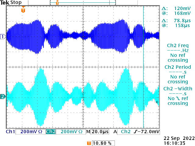

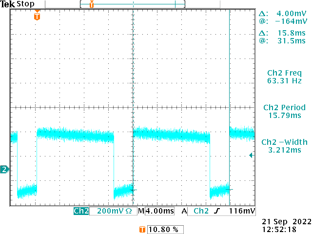

  • Hi Steve,
    I am still investigating the issue.  I have not found any information on the reserved registers so far, and I don't expect the GPIO registers having an effect on Port 1 as stated in the "GPIO Control and Data Registers (PCI offsets BCh, BEh, C0h, C2h, and C4h)" section of the Implementation guide.  This is assuming that the DNx_DPSTRPs are the same between the Internal Board and Eval board, but you have listed these as being different.  Is that true?
       - DN1_DPSTRP, DN2_DPSTRP are pulled high
       - DN3_DPSTRP in pulled low
    Attached is a summary of the issue.  Please let me know if any of the following points are not true:
    - Register settings are exactly the same between Port 1 and Port 2
    - Pin settings are exactly the same between Port 1 and Port 2
    - GPIO for port 1 and port 2 are exactly the same.  DNx_DPSTRAP is same for both, so GPIO is set set to hot-plug function
    - Failure is consistent across multiple boards
    - XIO3130 Eval Board and end-device eval board work well together
    - XIO3130 Eval Board EEPROM is the same as the internal board EEPROM
    - Port 1 generates what looks like a compliance pattern and does not complete link training.  Port 2 works well.
    Is it possible that the EEPROM is not being loaded?  I see from the data you shared that the EEPROM sets 0xEA to 0x04.  Is the upstream subsystem access register (0xE0) match what is set in the EEPROM ?
    Nicholaus

    - Port 1 seems to generate a permanent stream of clocks on the PET lines. Exactly what the pattern correspond to is hard to say... Port 2 functions properly - the downstream device responds and can be accessed.

    By the way, does the PCI_D4h general control register in the PCI Config space match for Port 1 and Port 2 after you made the modification to the crystal on the Port 2 device?

  • Hi Steve,
    I'm wondering if the Port 2 oscilloscope screenshot that you shared that looks like a clock pattern is actually the XIO3130's Rx Detection pulses, and the XIO is not detecting a valid termination by the end-device.  Is there any way to confirm that the the end-device Rx on Port 2 is terminated in 50ohms (100-ohm differential)?
    In the Port 1 Tx this pattern goes away; this may be because the 50-ohm Rx was detected and it has moved into the Polling state.
    I will see if I can get the XIO3130 to produce Rx detection pulses in the lab to compare with yours.
    Nicholaus
  • Hi Nicholaus,
    Just so we're clear: Port 2 is the functional port - it's Port 1 that is non-functional. The REFCLKO's on both ports are terminated to 50 Ohms according to the device datasheet and eval board schematics.
    The TX lines on Port 1 never seem to exist the initial polling state. See following image: Functional Port = Port 2; Non-functional Port = Port 1
    Steve
  • Hi Steve,
    Sorry for the mix up. I am asking if the TX lines, not REFCLK, is terminated in 50ohms (100 ohm differential) by the end device.  It it's possible the end-device may have it's pins in a high-Z state or is marginal.
    The initial state for a PCIe device is Rx Detect.  It sends pulses out of the Tx lines to detect if there is a valid 50 ohm termination.  If there is, then it means there is a device connected and it will continue into the polling state.  When in polling the end device should respond with TS1/TS2 packets, if there is no TS1/TS2 packets detected after a certain amount of time, then it will go into compliance and should transmit something other than a clock pattern.
    As you have said, what we see doesn't seem to be either polling or compliance.  So, my thought is that the XIO3130 Port 1 is actually stuck in detect and never makes it to polling because it cannot "see" the end device due to the lack of a 50ohm termination at the far-end Rx.
    Nicholaus
  • Hi Steve,
    Sorry for the long delay.  A couple of the XIO3130 EVM boards I was testing with were bad, so it took a while to get the data.  However, it does seem like there could be issues with the termination impedance on the PCIe Tx lanes coming from the XIO3130 on port 1; a 50ohm termination value should be provided by the Rx of the end device on port 1. Rx pulses on the Tx lines will look like a high-duty clock signal that repeats about every 14ms.  Here is an example from an XIO3130EVM in the lab.
    Below is a scope shot you sent me.
    If there was a 50ohm termination at the far-end of the Tx lines, then this signal should not be visible.  PCIe devices often have the ability to switch between high-Z and 50ohm.  Can you confirm that the impedance seen at the Rx of the end device on port 1 is close to 50ohm and not high-Z?
    Nicholaus

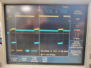

  • Nicholaus,
    I was able to solder terminations to the lines and they certainly changed the behavior of the signals, but did not change the actual result - the device is still not responsive.
    The following are images of the TX signals before/after the addition of the terminations:
    I do have a question for you regarding the XIO3130's detection mechanism: You state that the device detects the impedance on the signals and determines whether or not a device is present. What is the tolerance on that impedance? 50-Ohms +/- ?
  • Hi Steve,
    That impedance is defined by the PCIe specification as 40ohm minimum, 60ohm maximum.
    The next sequence should be polling, then the end-device should respond to the XIO3130 with TS1/TS2 packets, and then it should move into configuration and establishing a link.
    If the end-device does not respond with TS1/TS2 packets, then the XIO3130 should move into compliance.
    Here is a screenshot from the lab after I terminated the lines with 50 ohms.  Right now I only have my low-bandwidth scope, so I can't see the actual pattern yet, but this should be a compliance pattern.  I will confirm as soon as a high-speed scope becomes available.
    Nicholaus

    We think we just found the answer, but it's bringing up another question that I'm hoping you'll be able to clarify.
    It appears as though the REFCLK Disable bit is being set to '1' during the boot process, but we're not certain by whom. I've got my low-level software guy telling me there's a "0%" chance of the coreboot setting the bit, yet the bit is definitely set to '1' if I read the General Control Register at offset 0xD4. It's also NOT set on the eval board, which is running under Windows, so that further bolsters the idea that it's a low-level issue.
    What's more curious is that the corresponding bit on Port 0 is NOT being set (which explains why Port 0 is working fine).
    To recap: We've seen this issue whether the EEPROM is initialized or not. Bit 1 is set to '1' on Port 1, but NOT on Port 0. The EEPROM contents are defined such that the bit should be initialized to '0' when the EEPROM is used.
    I've asked the low-level software guy to ensure there are no "hidden" accesses in the code that secretly set this non-standard register, but while this is being done, I'd like to get your feedback on the following:
    1. Any ideas (other than software) why is Port 1's bit set to '1' while Port 0's bit is properly initialized to '0'? (Again, we're looking at a software cause for this)
    2. Are there any errata that may affect the loading of the configuration bits on power-up?

    With regards to your question regarding R3782: This resistor allows us to gate the Ethernet controller's RST# pin with the PERST# signal of the PCIe switch downstream port. As you saw from the schematic, the default is NOT to include the downstream port's PERST# signal, but to generate the ethernet controller's RST# using another signal, derived differently. The caveat here, though, is that the timing of the reset signal does not necessarily coincide with the REFCLK having been stable for a predefined amount of time:
    As you can see from the image above, the top signal is the "default" RST# generation for the i226 ethernet controller. The middle signal is the PERST# signal rom the downstream port. We do have the ability to route the DN1 PERST# signal to the i226 controller, however we have found this is does not seem to be necessary for the following reasons:
    1. Doing so had no effect on whether or not the data link trained properly.
    2. The work-around we have implemented works under the conditions shown above (i226 RST# generated by default mechanism).
    NOTE: The cease in REFCLK oscillations shown above appears to be due to the faulty i226 crystal oscillator, as discussed earlier. For the purposes of this discussion, the salient information is the generation of the RST# signal vis-à-vis the arrival/stability of the REFCLK.
    As far as the Disable bit is concerned, the waveform below suggests that the bit is set approximately 2.2 seconds after oscillations begin:
    Adding the RST# signal and running our modified coreboot, this is what we find:
    From this mage, we see that the REFCLK oscillation stop at about 2.4 seconds (after removal of RST#), but resume approximately 1 second later (presumable due to our work-around).
    I don't really know if all this information will help to narrow-down the cause of the bit-assertion, but it's the best I can give you in terms of externally-visible  information that may help track down the problem. If there is any other measurement that would help you isolate the problem, please let me know.
    I will look further into the Section 5.2 references to see if I can find anything pertinent. We can touch base again next week.
    Steve

    According to the datasheet, the hardware default (i.e. in the absence of an EEPROM) is that the bit defaults to '0'. We have tested this case (EEPROM contents programmed to 0xFF), and we see the problematic behavior (DISABLE bit set to '1' requiring re-programming).
    With the external EEPROM programmed (General Control Register[15:0] set to 0x6010, as shown in various examples), we again see the same behavior (DISABLE bit set to '1' requiring re-programming).
    This doesn't really leave us much in the way of alternatives. We are currently verifying the status of this bit as soon as the device is able to respond to PCIe accesses on the Host Interface (as soon as it is programmed). We are reading a '1', which cannot be explained by a software access, and based on your response, we don't understand how the bit is being set...

    If you think it could be useful, I could provide additional dumps either at the same point or subsequent to the complete boot process (once the application of our work-around is complete and we have booted into linux). To be truthful, I don't think those additional dumps would be particularly helpful, but I can get them for you should you so desire.
    Thanks for your feedback and suggestions.
    Steve
  • Hi Steve,
    I will review this data to let you know if I see any interesting information from it and get back to you ASAP.
    Nicholaus
  • Hi Nicholaus,
    I'm just checking in to see if you've been able to determine anything based on the data I provided and also with a question...
    Is it possible the REFCLK_DISABLE bit can be set if PCIe link training fails?
    We seem to observe the TX+/- lines transmitting a repetitive pattern even though the REFCLK has stopped oscillating.
    Thanks for your help,
    Steve
  • Hi Steve,
    The REFCLK_DISABLE bit cannot be set by the XIO3130 except for in the event of a power fault trigger, which is disabled.  So, there should be no way the XIO3130 can set this bit even if PCIe link training fails based on the information I have.
    I did see something interesting in the data you shared. The prior data I have matches board 2, but what was interesting in both cases it seems like bits 7, 13, and 14 should all reflect the value of the DNn_DPSTRP pin; however, they are different.  Is this due to differences in EEPROM on each board?  Hot plug should be implemented to avoid the REFCLK timing issue mentioned in the errata, so this might be related to the issue if these bits are changing during boot.  Please review the attached image.
    The downstream Tx Lines are still transmitting even when the downstream REFCLK is not?  I wouldn't think this should happen.  Can you send an oscilloscope shot of the REFCLK turning off while the pattern continues to transmit?  I can pass this on to design and maybe it will bring up some ideas.
    Nicholaus
  • Hi Steve,
    Has there been any explanation for the differences or other updates?
    Nicholaus
