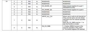

  • I found out that in the global register, 0xFC should enable all 4 channels,
    I am not sure about the global 0xFF

  • I tried to save global 0xFC, it seems can not be saved.

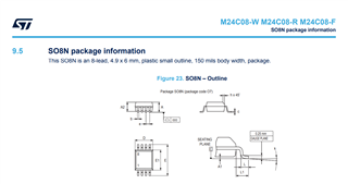

    I tried addr_0x44.hex, still the connection is down. Can you please help review the schematic to find anything wrong?
    Out caps are on the other side, and EEPROM model is M24C08-RMN6TP
    www.digikey.com/.../1663582
  • Hi Gang,
    Thank you for sharing your schematic. READ_EN should be pulled low in order to start EEPROM read function.

  • Hi Drew,
    Can you please suggest an I2C EEPROM with SO8 package? Is it possible that EEPROM does not acknowledge and retimer halt the communication?

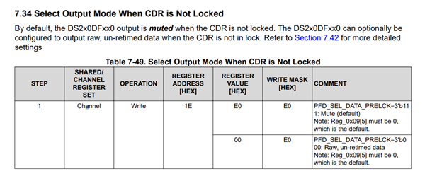

  • Hi Drew,
    What we did for EEPROM update, I will try it next Monday:
    (1) load 0x44.hex in EEPROM page
    (2) go to low level page, and uncheck bit 7,6,5 in register 1E for all 4 channels
    (3) go to EEPROM page, update slot from device and then write to EEPROM

  • Hi Drew,
    We tried the modified EEPROM, but the link is still down. We also tried disable the auto negotiation on ethernet switch, same result.
    Would you please help double check whether the below image is correct?
    I can not attach a file into this forum, I paste the modified image with RAW selected here:
