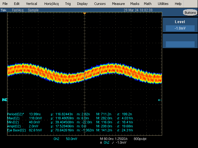

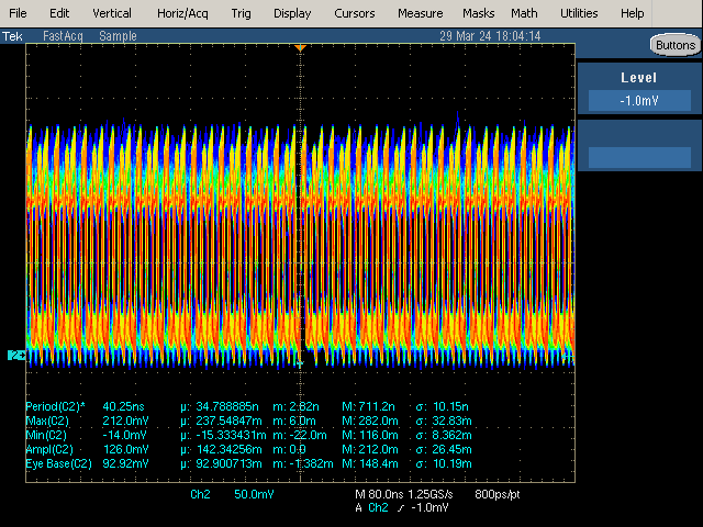

  • What creates the waving pattern on the output of the ONET1141L if NO modulation current is set?
  • May this couple into the output if we have set the modulation current to extension ratio of 1/10 P0/P1?

Please find pictures of waving pattern with and without modulation current measured external PIN diode.
No Modulation current, PO = 6mW
Modulation current, PO = 6mW, bias ~ modulation current

    2. The shown waveforms are optical output collected by illuminated external photodiode by Laser diode. This is a separate optical device. It is DET10A from Thorlabs.
    3. We checked the noise at other laser diodes and it is less significant. It seems that ratio of output optical power / MPD current helps. With large range it just decrease the problem not solve.
