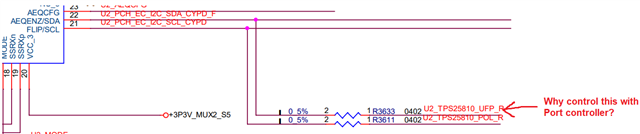

I reviewed the TUSB1142 in your schematic.
This review is for U3400, however all 3 devices seem to be implemented identically, so you can use this for the other two as well: TUSB1142 Review.pdf
One thing I was confused about is why you control the AEQENZ pin with the port controller? Is this intentional?

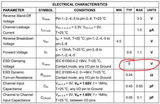

The 1142 looks correct in the schematic. One thing I noticed is that your ESD protection clamps at 9V:
I recommend using an ESD diode with a lower clamping voltage (closer to 3V is ideal). A device we typically recommend is the PUSB3FR4.

The ESD diodes look ok now. If the customer wants 8kV ESD protection, you can add 2 ohm resistors on the signal lines between the capacitors and ESD diodes as well.
The FLIP logic looks correct, as you have an inverter between the port controller and the 1142. This should align the MUX correctly with the active CC channel.
