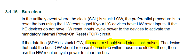

Hello Bobby,
Interesting... Where can I find some information about this 'resuscitation' method? Is it related to a specific functionality of the device or is it part of I2C specification?
regards,
gaston
Hello Gaston,
"Where can I find some information about this 'resuscitation' method?"
This is specified in I2C standard though I mention 18 clock pulses to be sure the device releases the bus the standard states 9 clock pulses.
Here is a snip-it on page 20 of the standard:
"Is it related to a specific functionality of the device"
-No as this should work with all I2C slaves. It is because the slave's state machine is no longer in alignment with the actual I2C clock. This could happen because of noise, hot plug event, parasitic inductance generating ringing on the line, or cross talk to the I2C clock line. The 9 clock pulses should reset the state machine of the slave so it can see a stop condition.
I should mention as well that there are some devices out there with a feature called "stuck bus recovery" which will actually detect if the SDA line is latched low and will automatically generate 9 clock pulses to try to release the bus.
