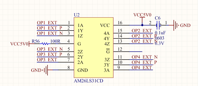

I use the AM26LS31C chip as the RS422 transmitter. The input of the AM26LS31C is the LVCMOS33 signals generated by FPGA. The schematic of the AM26LS31C as shown in the figure.

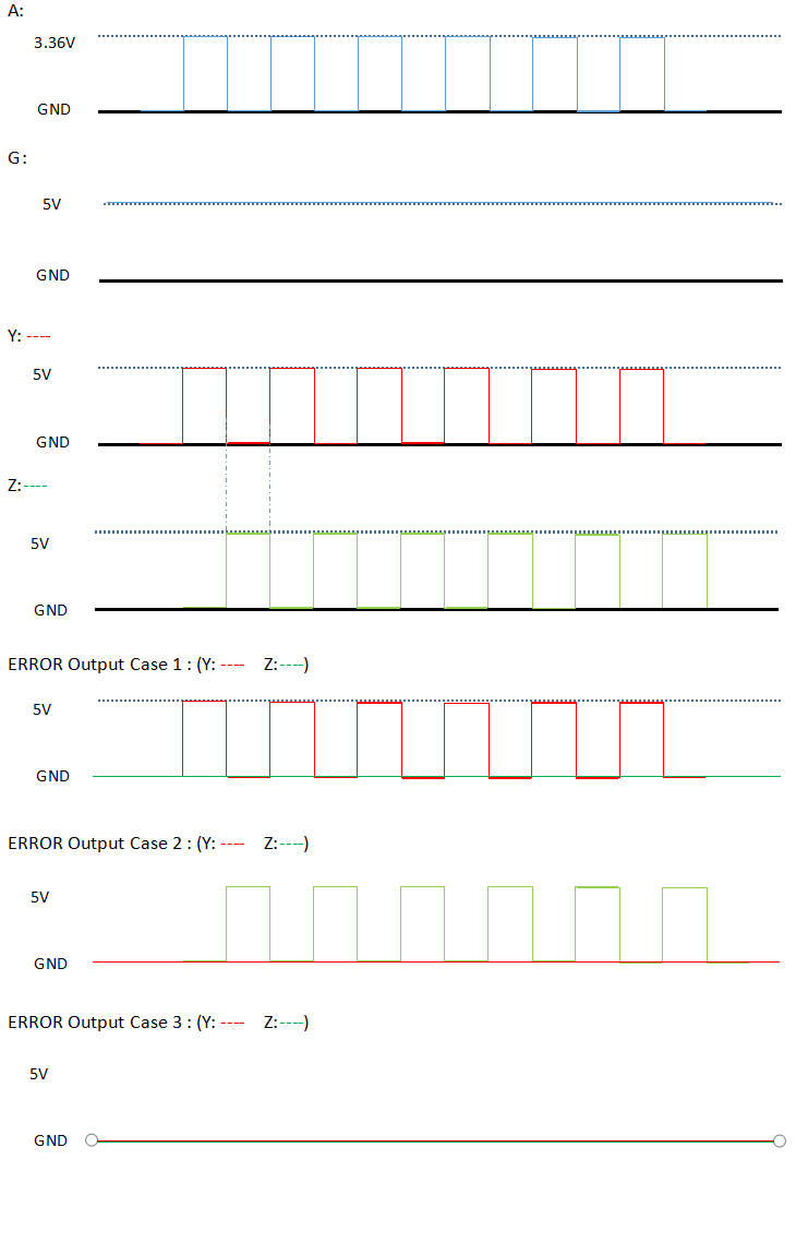

In the circuit testing, I found that OP1_EXT, OP2_EXT, OP3_EXT and OP4_EXT are LVCMOS33 square wave signals with a frequency of about 6KHz. However, at the output of the AM26LS31C, sometimes there is no signal at the Y OR Z,and sometimes there is no signal at both the Y AND Z.
I tested the operating temperature of the chip, which is between 40° and 60°.
When I replaced the chip supplier, the problem still exists.
Could someone please give me some advice on the use of AM26LS31x?
