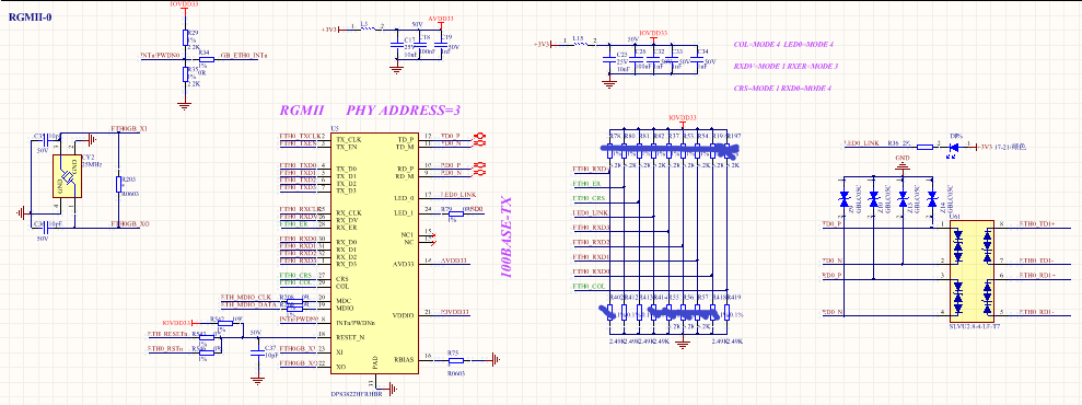

We are penetrating DP83822 in their new project. Customer wants to know when using MII mode, can we capture clock signal in RX_CLK and TX_CLK?
And they are testing MII loopback, failed, the register 0x01's bit 2, link status didn't change, still 0. So Mac can't send data to PHY? Could you please help provide some advice to help solve this issue? Thanks.

I suggest sending us your schematic for review.

Please send a schematic so that we can review it and catch if anything is incorrect.

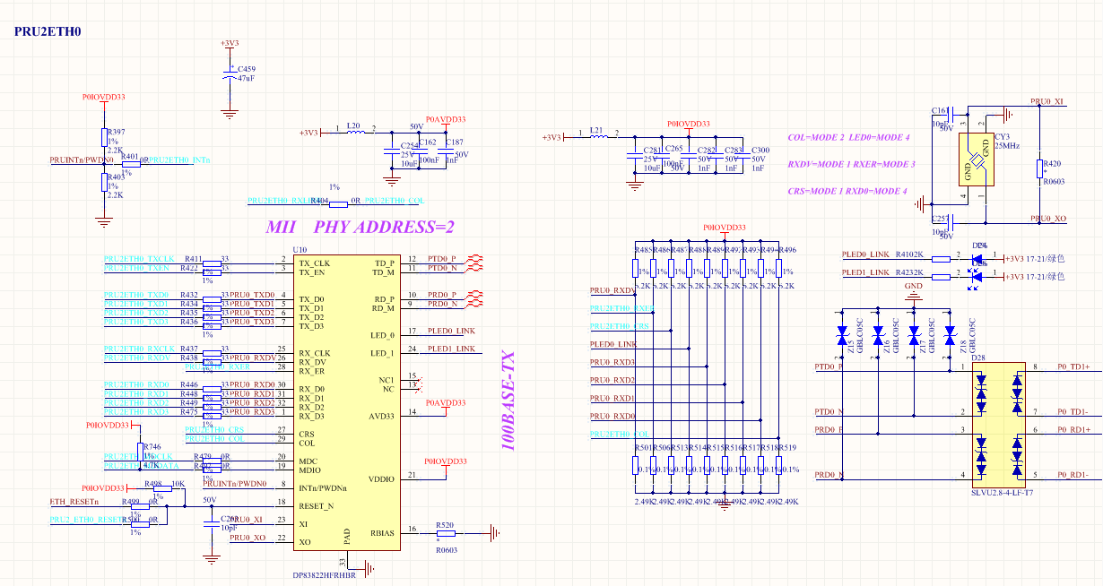

Hi Lin,
Please DNP R401 and see if this resolves the issue.
Are there any components that are DNP but not listed?
What is the value of R520?
Are all the bootstrap resistors stuffed or DNP or combination, if so which ones are DNP?

Hi Ross,
Thank you for your response here. Please see the my updates below,
1.DNP R401 cannot solve this issue;
2.For the strap pin, only COL, CRS, and RX_ER have 1.96k pull down resistor. To set the MII mode and PHY address 0;
3.R520=4.87k;
4. Vreset=3.3V;
Do you have any other suggestions for me to find the root cause? For we cannot read PHY address from MDIO. Thanks.
Hi team,
Could you please help share me some suggestions to find the root cause? I have tried many methods but failed,
1. Increase RESET capacitor to 1nF, failed;
2. Remove INT pull down resistor, failed;
I cannot capture RX_CLK and TX_CLK from our PHY and cannot read register from MDIO pin. We need your help to solve this issue quickly. Thanks.
Hi Lin,
Can you please have them remove the series resistor on LED_1 please and test again.
From the email you sent me, it looks like LED_1 is going into strap mode 2, which is a test mode.
