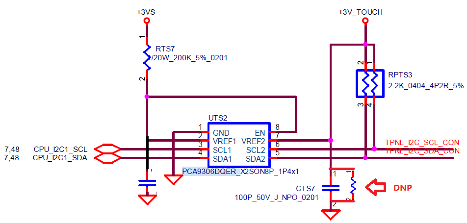

    Below is a capture of the schematic. Where the "+3Vs" may be 0 or 3.3V and +3_Vtouch" is always 3.3V. Need to confirm there is no leakage concern on both cases. Do you think the design is OK?

  • The enable is set up improperly. The enable pin should be shorted to Vref1 based on your previous statement (not tied directly to 3VS). Currently your set up would allow for very large current from Vref1 to Vref2 if Vref2 is ever GND while Vref1 is powered larger than 0.6V.
    PCA9306 will be HI-Z across the SDA/SCL lines if the enable is referenced to GND so there would be no leakage between those nodes. Some leakage could be present if Vref1+EN to Vref2 if Vref2 is zero while Vref1/EN is high.

    So in short, changing the pin 8 resistor from 200K to 0 (meaning to short EN/VREF1 both to +3Vs), then no issue for the design?
    Max
  • The 200k limiting resistor still needs to be present, the ENABLE pin and the VREF1 pin need to be shorted together then from there a 200k resistor into +3Vs.
    I would also place a DNP pull down resistor on Vref2 incase the power supply on Vref2 cannot handle leakage current into that path.
    -Bobby

    Could you help to confirm if the below design seems OK to you?

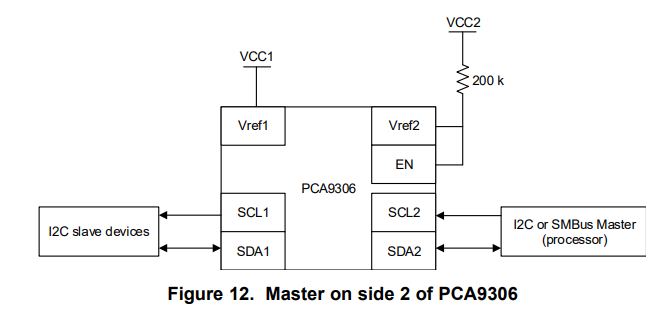

    And actually in this case, shall we simply change Vref1 to +3V_Touch  and Vref2 to +3Vs, where Vref1 will be always 3.3V while Vref2 could be 0/3.3V. And also switch the I2C on both sides. In this case it seems to match the reference better. May I get your confirmation which one is better from design point of view?

  • Hey Max,
    Originally, you were saying +3V_Touch was always on while +3Vs could be either on or off.
    With how you currently have it set up (meaning Vref1 is tied to EN directly and Vref2 is alone), I would place the power rail which is always on to be on Vref2 and the power rail which could be on or off to Vref1/EN through 200k ohm limiting resistor. That way if the Vref1/EN rail is off, the device would be powered off and HI-Z. If you had it set up opposite where Vref1/EN were always on and Vref2 were sometimes off, you would see some biasing current from Vref1 to Vref2 in the microamp range (which is why I suggested a DNP pull down resistor).
    Also, the decoupling cap should be placed on the EN pin as well.
    Since you referenced figure 12 from the datasheet, if you want to use that set up instead to line up with the datasheet then you would place the always on power rail on Vref1 instead and the potential on/off rail connect to Vref2/EN through 200k resistor. (EN pin should have a decoupling cap and Vref1 would then have the DNP pull down resistor just in case).
    -Bobby

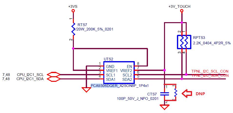

  • Thanks very much for your explanation Bobby.
    I think I'd suggest customer to use what we premarily suggested.
    Please kindly help to confirm if any thing need to be modified on below update. Then I should be able to release it to customer as final design.
    Thank you.
    Max
  • Hey Max,
    The schematic looks good to me, no concerns from my part.
    -Bobby
