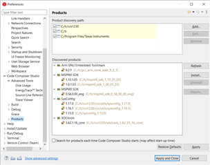

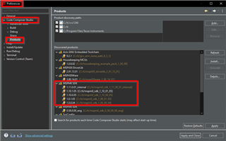

Can you verify that the SDK is added as a product in CCS? To do this go to Window -> Preferences
Then Select Code Composer Studio -> Products, and verify the MSPM0 SDK correctly shows up. If not, ensure the "C:/ti" path is checked, and hit the "Refresh" button.
