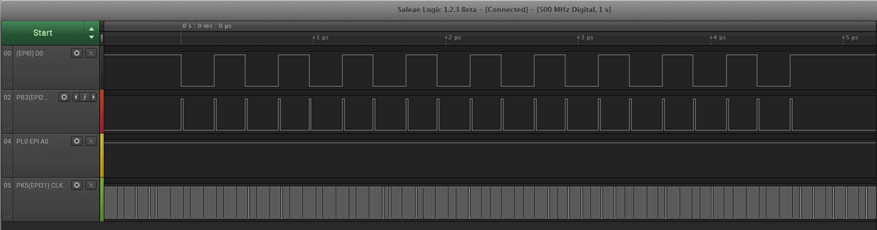

There is probably something I am missing in the config but the  Write frequency is somewhat slower than I expected. The time between reads varies from 800ns to 1.7us. The printscreen shows what I mean, first signal is EPI Data 0 and is toggled every write (that works)...:
EPI clock runs properly at 60MHz, there are really some long delays between Writes (or reads, have the same effect) that I cannot explain.
I disabled interrupts and it didn't change anything. By default should be the "Ready" signal disabled so I don't see what could be delaying Read or Write between each "for" cycle.

    I tried turning disabling all interrupts with ROM_IntMasterDisable();
    The timing is then somewhat more constant but is then still "blocked" at ~250ns per WRITE cycle

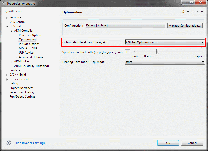

    I tried removing all "ROM_" prefixes in these functions to simplify the code but it hasn't changed anything. Then I tried starting a new blank project with the same initialization code but without any extra peripherals. Sure enough it worked as you stated... Only difference was not in the code I wrote in my original project but in the compiler settings. I had turned off the Optimization since I had problems with debugging and read that turning optimizations OFF for debugging gave better results. With Global Optimizations(2) my project now works with 50~60ns period for writes and 100ns for reads. Will test later with µDMA but I am sure now it'll be ok.
    Thanks again for your help and I am sorry for making you search a problem where there was none! At least next time someone reports a "delay problem" you'll have another place where to suggest looking.
