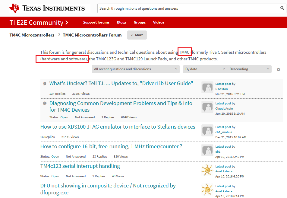

  • I see this thread now has 481 views. Do you suppose that all these people were looking for a pointless debate about the merits of TivaWare? Probably not. It is more likely that, like myself, they just want to know if a TM4C timer can be configured to free-run at 1 MHz.
    Thanks for hijacking my thread...
