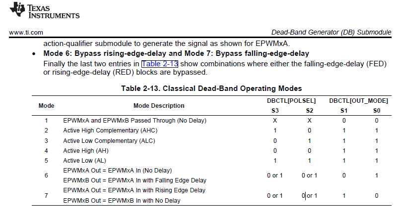

Note below the Piccolo F280 has multiple modes of dead band and gives a nice illustration of the various wave forms depending on the mode set by the Polarity bit.
  • BTW Piccolo table 2-13 mode 6 comes closest to the behavior being described above post (set, reset inverts pwmB). Notice points 6:7 Bypass modes in table 2-13 are seem reversed in the table, likely by mistake.
    That of course if By passing pwmA
