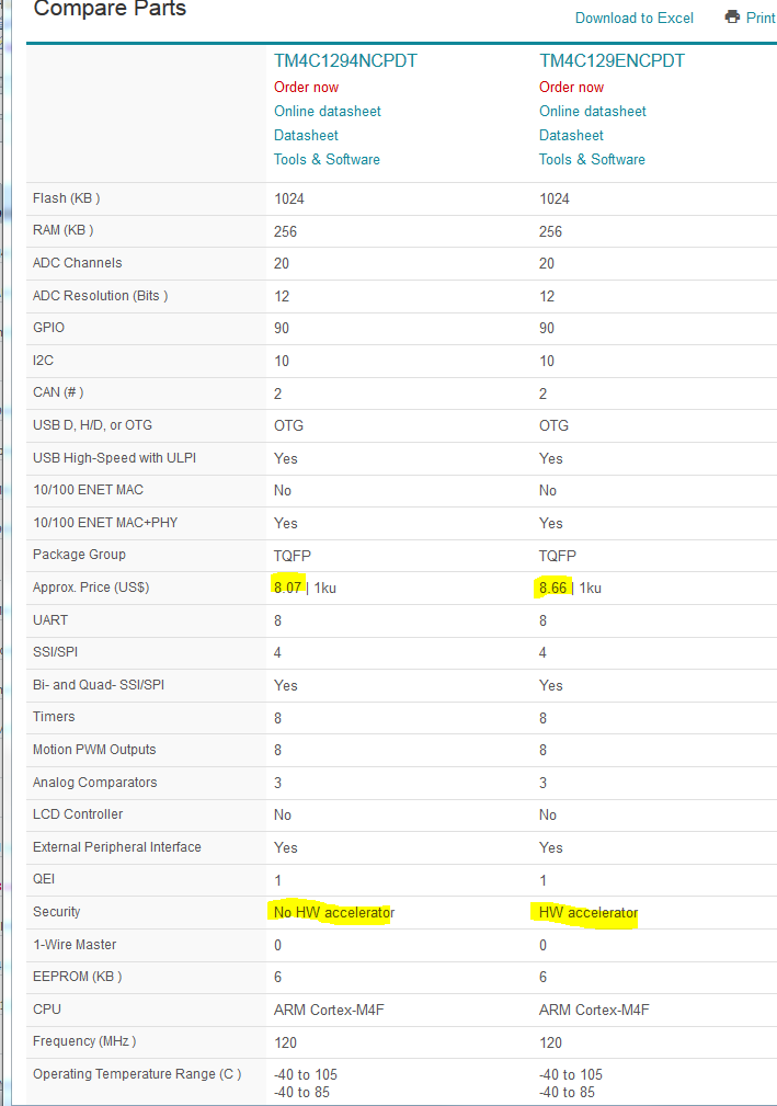

The short answer to all of your questions is yes. You can drop in replace the TM4C129ENCPDT with the TM4C1294NCPDT if you do not use the hardware encryption accelerator. You can use the online comparison tool: http://www.ti.com/product/TM4C1294NCPDT/compare
Here is a snapshot of the comparison of these two parts:
