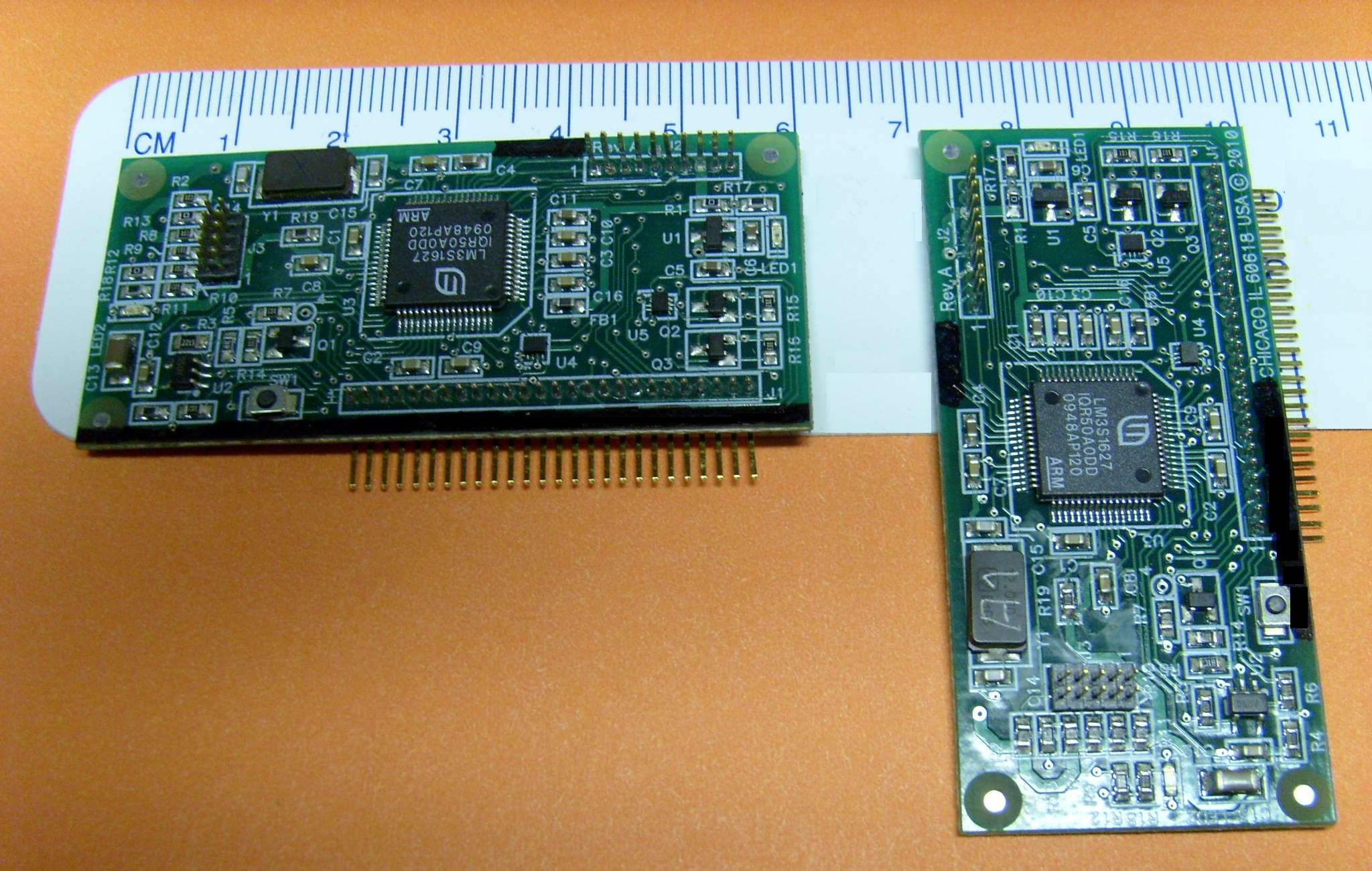

In the past i was using tiva-c for my embedded porjects, but right now i need a smaller board for my last project. Can anyone recommend a board that can be developed from code composer an is smaller then tiva c for example the size of an soic8 breakout board.
  • balauroiu radu said:
    ...right now i need a smaller board for my (next) project.     Can anyone recommend a board that can be developed from code composer an is smaller then tiva c for example the size of an soic8 breakout board.
    Probably not - is it not a fact that '64 QFP' is the 'smallest sized Tiva/TM4C MCU?'     Placing a 64 pin device while routing (even) half (the number) of MCU pins to the pcb's edges is sure to, 'Exceed the size of an 8 pin soic breakout board.'
    If you can 'shield this post from vendor's eyes' - you may consider, 'Alien ARM Cortex M0s/M0+s - which (are available) in reduced pin count packages - even 8 pin soics!    Do note - that such size reduction significantly reduces the number of MCU pins - available for your application.    As usual - Engineering often demands 'trade-offs' - it is rare to find a 'Solution' which: Meets 'Everyone's Requirements' - at 'All times.'
    I'm 'away' from the office at the moment - staff will provide several comparison photos (upon their arrival tomorrow) which should aid your grasp of 'typical MCU board sizes.'    The photo below reveals a (past) 'LM3S' MCU in a 64 QFP package - developed by my firm - and which is significantly 'smaller' than the vendor's 'TM4C123 LPad' - which is believed to be their 'most size-reduced Development Board.'     Do note that the vendor's LPad includes a 2nd MCU - which serves the ICDI (programming/debugging functions) - which is not present upon my firm's board.    (Instead we program/debug via 'J-Link & IAR's 'Pro' IDE' - which attaches to the '10 pin, 0.050" pitch header - -  located near the bottom of the vertically placed (right) pcb, below.)
    In contrast - the vendor's TM4C123 LPad measures 65x50 mm - our board (above) is 60x28mm.     Tomorrow staff will provide an 'A-B' photo comparison.

  • Can you provide me an link to a site from where i can purchase this board. Maybe i can find there an datasheet of this board, pinout schema, number of adc channels, etc...
  • CB1,
    Thank you. You are correct. The EK-TM4C123GXL (which you mentioned above) is the smallest development board for the TM4C family available from Texas Instruments.

  • CB1,
    I have an question about the board that has 6cm ( the one without lcd ),  can be flashed/debugged with Tiva-C launchpad using code composer ?
    If the answer is yes can you provide me the connection between Tiva-C launchpad and the green board.

    Our board employs the (more recent) 'space saving - 10 pin (0.050" pitch) JTAG Header' (clearly noted - w/in the photos) - so if you can properly mate to that you should be (almost) fine.  (Do note that this reduced pitch board header employs 'thinner pins' than those found on the LPads - thus a 'normal connecting lead w/female socket' - may not yield a secure connection.)    Several header/connector vendors produce 'mating female sockets' for the (now almost standard) 10 pin, 0.050" pitch, JTAG Header.
    Suggest that you familiarize yourself (first) w/the various, 'JTAG Connection Methods' - this vendor has produced a nice,  'JTAG Connector Comparison write-up' -  which much boosts your understanding...   As your, 'Method of Connecting to the 'mini 10 pin JTAG Header' is 'unknown' (and is critical) - that must (first) be resolved...   (Note that we normally produce/provide product to OEMs - who have 'long mastered' this 'latest/greatest' 'Mini JTAG Header Connection.')
    Photo best illustrates:
