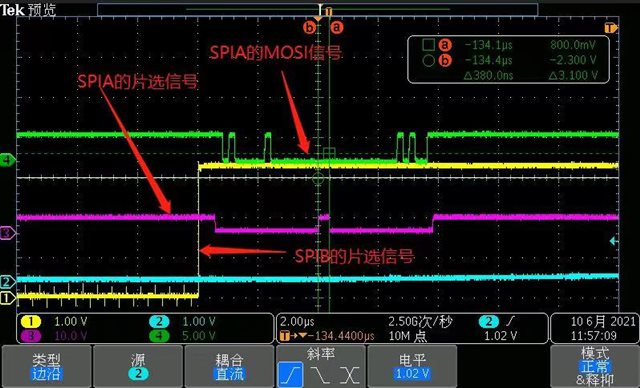

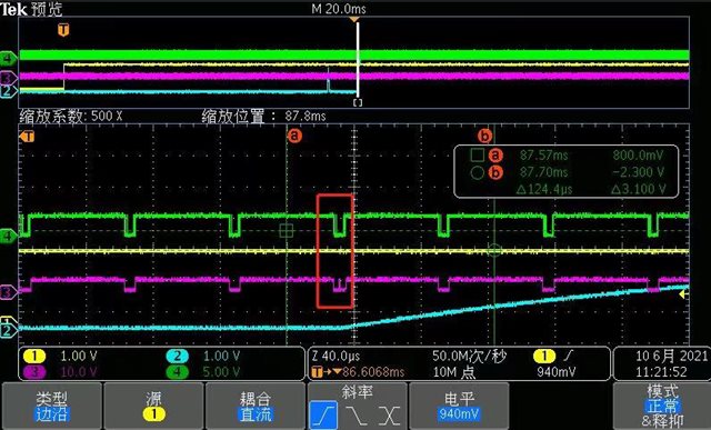

Customer code operate only SPI_A  as master mode in normally without any issue, however we found the SPI_A STE signal will become abnormal if we also enable SPI_B master operation, you can check the SPI_A STE signal abnormal waveform in below red block.
More detail show in below waveform, after SPI_B finish translation and STE (yellow color) become low to high, the SPI_A start translation and STE (purple color) become high to low, however SPI_A STE will have an abnormal high pulse in the middle of MOSI (green color), it cause the SPI_A communication error in that frame. May we know if anyone know such issue?
  • More detail show in below waveform, after SPI_B finish translation and STE (yellow color) become low to high, the SPI_A start translation and STE (purple color) become high to low, however SPI_A STE will have an abnormal high pulse in the middle of MOSI (green color), it cause the SPI_A communication error in that frame. May we know if anyone know such issue?
    Please explain the clearly. I'm not able to understand the problem you're trying to explain here?
  • In normally, when SPI_A send data, STE driver to low and should keep low until 16bit MOSI signal finished, then STE turn to high.
    However in sometime,  STE do not always keep low in one frame,  it will goto high after 8bit MOSI data, then return to low after one clk, then after remain 8bit MOSI data, STE turn to high. This abnormal frame will cause SPI communication error.
    We check many waveform and finally find such SPI_A issue frame usually happen just after SPI_B finish sending (it means the timing that SPI_B STE turn to high).  Although we think the SPI_A and SPI_B should be independence module, it seem SPI_B affect SPI_A STE signal and we cannot understand the reason.

    we have not tried it in TI board. But we try modify customer code to change STE pin function to GPIO, then operate this signal by GPIO set/clear to replace SPI module STE function, and the issue disappear. So that issue likely SPI module affection but not board artifact.  And look the waveform for SPI STE abnormally pulse, it is very stable for one clock, it do not like a noise but more like a logic signal. so we are suspect if any possible condition will trigger such logic signal from chip internal circuit?

    The issue has find the root cause, after SPI-A send 1st 16bit frame, it is halt by SPI-B receive interrupt, so SPI-A STE goto high; then after interrupt finished, SPI-A continue send 2nd 16bit frame so that STE goto low again. Customer can solve this issue, Thank you support.
