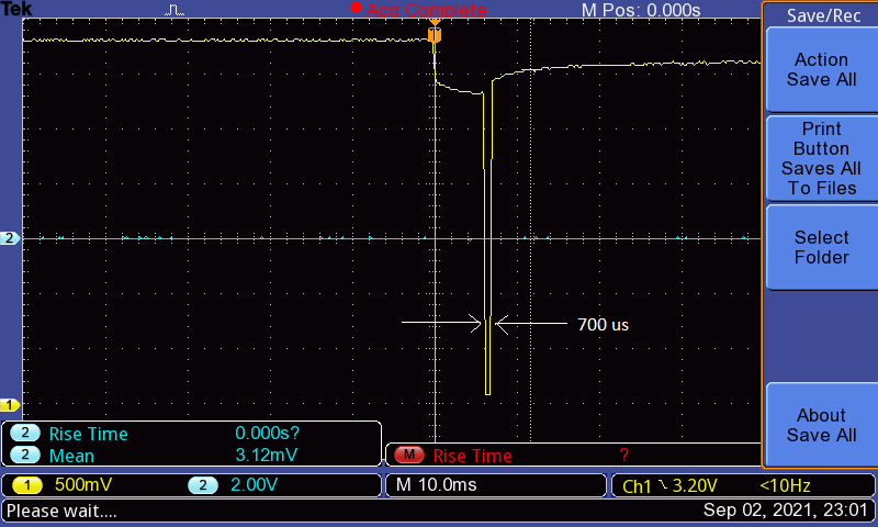

TMS320F28069M: InstaSpin Trouble Reading Register PC: (Error -1142 @ 0x0)
Part Number: TMS320F28069M
Other Parts Discussed in Thread: C2000WARE, DRV8301
I'm trying to run labs for Instaspin on a custom board, and keep getting the following error message -
"Trouble Reading Register PC:
(Error -1142 @ 0x0)
Device blocked debug access because it is currently executing non-debuggable code.
Choose 'Rude Retry' to disable polite mode and force the operation.
(Emulation package 9.3.0.00058)"
Then the following message appears on a new separate tab:
"Break at address '0x3ff4fa' with no debug information available, or outside of program code."
Rude Retry does not work. Program execution stops at 0x3ff4fa, which is in the middle of the bootloader code.
Why on earth would it go there after executing the program faithfully for a little while (anywhere from 1 - 5 minutes)?
And the why would it just stop once it gets there? It looks like a software issue, just wandering off into memory
not intended for this kind of use, but it might be hardware related, since it does not occur on the
DRV8301-HC-EVM Rev. D board.
It occurs only on my custom boards, which are based heavily on the above-mentioned evaluation board.
There are 2 versions of the custom board - one with the XDS100 emulator on board, and one without
(using a separate XDS110 for debugging on this one). It happens on both.
Could this be due to cross-talk? I have a feeling my layout might be to blame...
Dave

  • Yes, it's lot numbers, no any other differences between these two devices you mentioned above. You have to check the customer's board to make sure that 1. the power supply of the F28069M and emulator are right; 2. the connection between them are correct as well; 3. The target configuration file (.ccxml) is set properly for the using emulator.
    Only modify the ADC, GPIO and PWM configuration and hardware parameters in user.h, hal.c and hal.h according to the customer's board, don't change the other code example lab in the first step.

    Another scenario that may be of help:
    Usually I just click the debug button while the focus is on the main program. But if I launch from the Target Configuration Tab, the following occurs -
    When launching with no particular project selected, everything is static. There are no errors, or anomalies.
    When I connect, though, the following message appears on a new Tab:
        Break at address 0x3ff75b, no debug information available, or outside of program code.
    It then allows me to load the program and run it. After about 30seconds, another new tab pops up with the following message:
        No source available for "_system_post_cinit() at C:\Users\dreagan\workspace_v10p3\Example_2806xScia_FFDLB\Debug\Example_2806xScia_FFDLB.out{3}0x3ff4fa{4}
    The address 0x3ff4fa is where the program has usually headed under these conditions. It's a STOP command, and is located in the Boot section of code, according to the Memory Map.
    Another thing worth noting is that I get the same message when I attempt a "CPU Reset" from Code Composer.
    I would not normally expect a Reset to go to this section of code. In addition, a Reset (after it's completed) should normally allow you to run the program.
    The address listed as 0x3ff75b is a new one. I have NO breakpoints set, so I'm not sure what the message "Break at address 0x3ff75b..." means.
    I've tried lowering the frequency of the JTAG clock with no success, but so far I've only tried 1MHz & 500kHz.
    Next - I'm going to try lowering the JTAG frequency even further. Then I'm going to try loading and running a very simple program that uses no interrupts, and see if the same things happen.
    After that, I'm not sure. We've been focusing on the JTAG, but could this have another cause?

  • Hi Yanming,
    I monitored 3.3V while launching, connecting, loading and running Example_2806xGpioSetup.c. There are no problems until actually running the program. After about 27 seconds, at nearly the same moment the program gets hung up (I can't tell whether before or after), the 3.3V drops to practically nothing for about 700 uS, as shown in the attached scope screenshot.
    Any idea what might be causing this?
    Please also see the previous post; i have a few other questions / comments.
    Dave
  • Also - here's the current being drawn from the 3.3V regulator (voltage across a 1 ohm resistor).
  • Please post the schematic of your own board, and what power supply is on the board when you run the program?
    Is it possible to change the lab01 according to your own board? And then run the lab01 to see what happens when only power supply for controller, no power supply to inverter?
    Or you might try to run a timer example without any GPIOs output on your board to see what happens. Obviously, the issue could be from your hardware board, it's not related to the emulator and software code.
