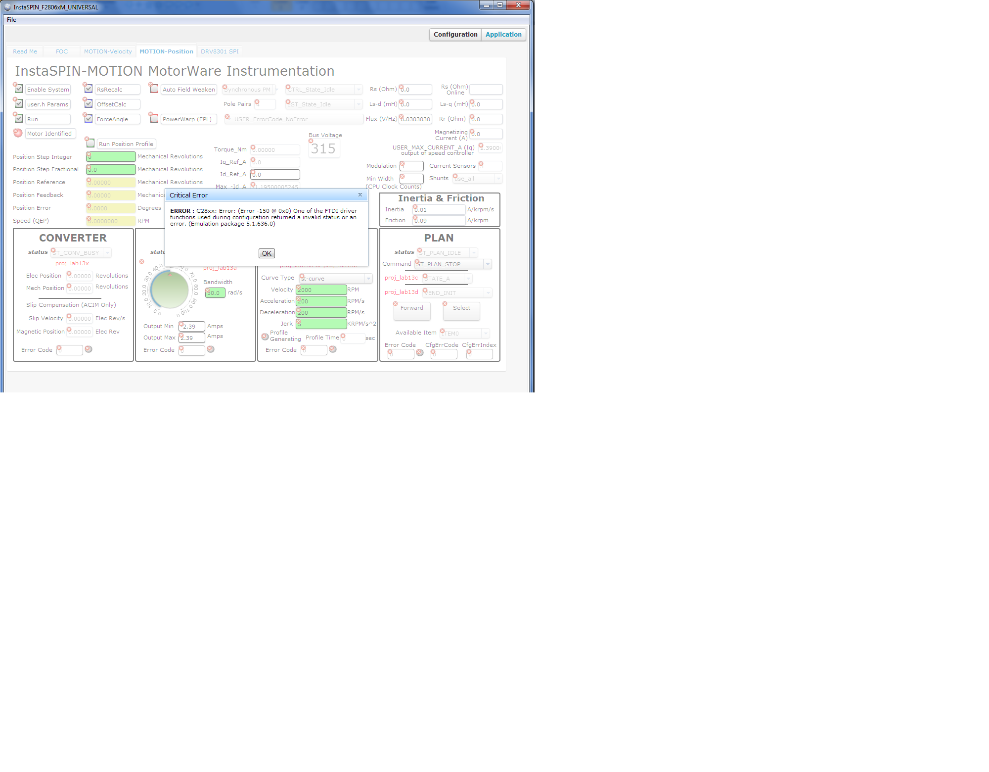

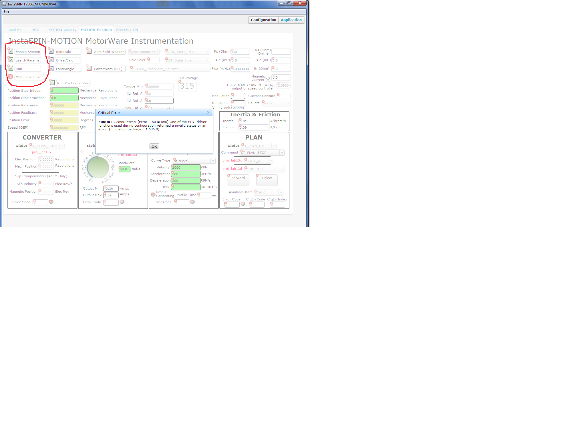

I am using hvkit_rev1p1 with control card TMDSCNCD28069MISO RELEASE 0.4 and motorware_1_01_00_14 project.
An error occurred when RUN flag set in the GUI
Here is a Screenshot This is creating a big trouble and I am not able to test the system
I am using CCS v5.5
please help me it's urgent
Thanks in advance

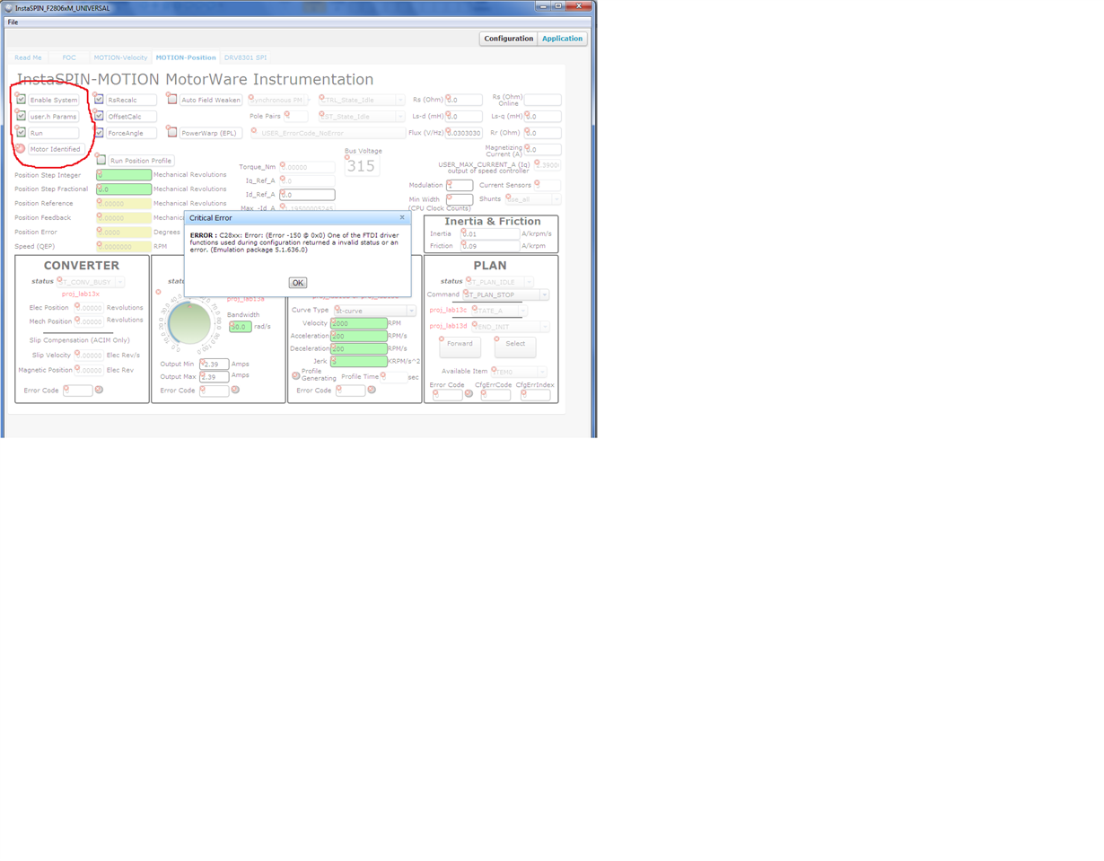

Hello sir,
As per our previous discussion after checking the voltages ,The Input voltage of emulator is OK and C18 and C19 showing 3.279V, 1.93V respectively but the expected voltage for C19 is 1.8V (According to sch.)
Hello Sir,
Switch positions on the control card is
SW1: Upward position
SW2: Downward position
SW3: Upward position
Is this switch positions correct?
and when I debug the program the LED on the control card blinking that means emulator not faulty but after setting the RUN flag error comes..
Sameer,
Can you try a different USB cable (ideally one with a ferrite built in)?
Your issue sounds very familiar to:
https://e2e.ti.com/support/microcontrollers/c2000/f/902/p/368668/1302180#1302180
Thank you,
Brett
