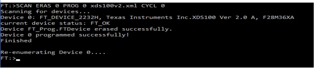

    1. Once you get the cCARD switches back in the right place, can you try reprogramming the FTDI chip using the .bat file found at the following link.  I don't think this is the issue - however, it's easy to rule out.
      https://e2e.ti.com/support/microcontrollers/c2000/f/171/p/252873/889381#889381

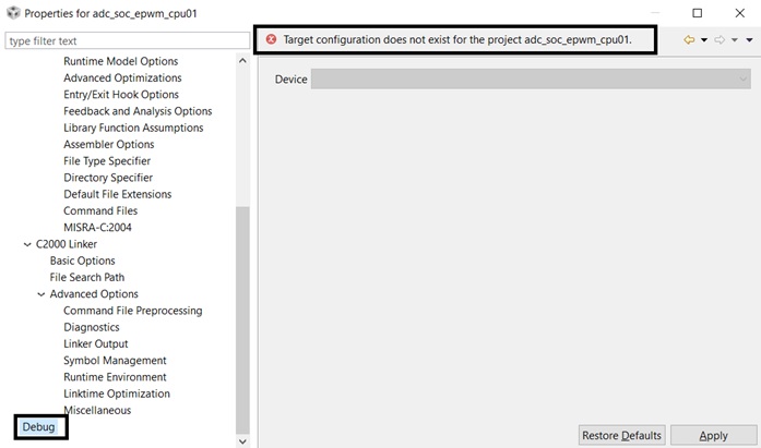

  • Hi Brett,
    I did the steps 1 and 2.
    I reprogrammed the FTDI chip as you have suggested.
    Unfortunally, it did not work.
    Do you have more suggestions to solve the problem?

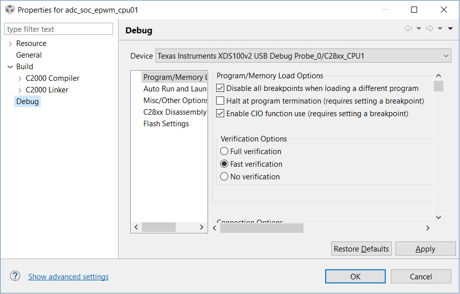

    I noticed that there may be a problem. See these figures.
    Can you explain why this ocurr?
    Thank you
    Weder.
  • Hi Weder,
    I'll have someone look at the target configuration weirdness, perhaps it's related to your issue.
    I thought of one other thing this morning:  When you have your USB cable plugged in the the emulator portion of the cCARD, what do you see on A:D4 & A:D3?  Are they constant on?  Blinking?  Or off?   If constant on, you may want to try changing the USB ports you are using.  If mostly off, this won't be the root cause for what you're seeing.
    Thank you,
    Brett

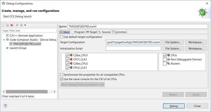

  • Weder
    Make sure your target config is set as "active" or as "default". Right click on it in your project explorer and select one of those options.
    Best regards
    Chris
  • Hi Chris,
    After a post, I identified this situation. I was restarting a project as an alternative to establish the connection but had not completed the configuration.
    Thank you
    Weder.
