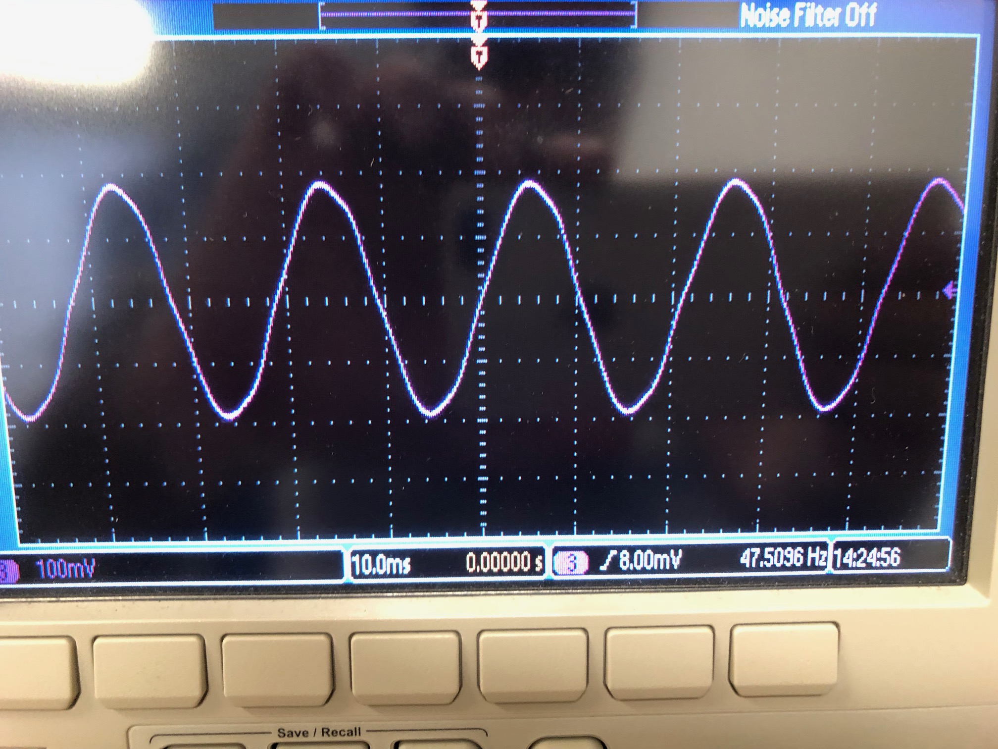

  • Hi Steve,
    Thank you for your input. Please see the waveforms for the encoder which seems to be clean and also the phase current at max speed. also increasing USER_MOTOR_RES_EST_CURRENT didn't help.

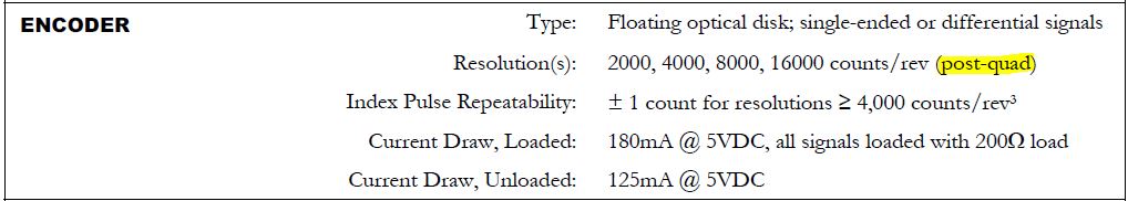

  • I think the encoder setting "USER_MOTOR_ENCODER_LINES" in user.h has some issue. You need to carefully check the encoder resolution spec. For example, the resolution in the encoder below is the value of post-quadrature. It means that the resolution(counts/rev) should be divide by 4 for USER_MOTOR_ENCODER_LINES because this lab use eQEP feature with quadrature enabled.
    Could you share your encoder specification?
    What the value of USER_MOTOR_ENCODER_LINES ?
  • Hi Steve, Thanks again for your support and helping us on this issue which is highly appreciated. We agree that there might be an issue with the encoder settings but not with the USER_MOTOR_ENCODER_LINES. The motor encoder CPR is 2500. So are you saying that we should try 2500/4 =625  ?
    What about encoder offset? How do we make sure the encoder offset is correct?
    And what does this number stand for ? #define ENC_ZERO_OFFSET 3813071.0
  • if there is no any comment like "post-quad" on encoder , USER_MOTOR_ENCODER_LINES is 2500.

    I’m still doubt if encoder feedback does not have noise.
    Could you check an encoder feedback again by running open-loop angle generation? You can add some data logging module, and can check encode count value or electrical angle while running motor with constant frequency and constant current with open-loop angle generation.

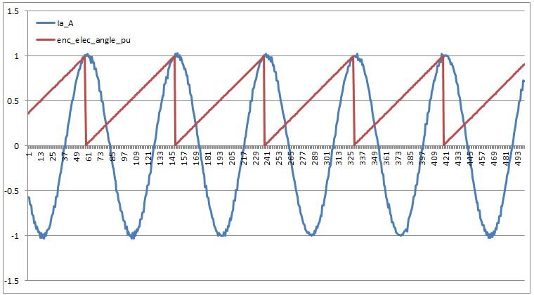

  • A1 A2) . the attached file is for open loop test, and has data logging module for graph. please find the following test procedure.
     step1. replace the origital proj_lab12b.c file with the attached file (proj_lab_12b_1.c).
     step2. add "sw\modules\angle_gen\src\32\bangle_gen.c" file into the project
     step3. compile & downloading & run
     step4. gMotorVars.Flag_enableSys = 1
     step5. gMotorVars.Flag_Run_Identify = 1
     step6. Set target speed (gMotorVars.SpeedRef_krpm)
    if gMotorVars.EstState becomes EST_State_Online, set the target speed with "gMotorVars.SpeedRef_krpm". 10~30% of rated speed is enough for this encoder test. You can increase Id current with gMotorVars.IdRef_A if you need more current for more high speed. The default value of Id reference current is same with Rs estimation current.
     step6. Data logging enable (Graph_Flag_Enable_update = 1) once rotor reach to the target speed.
     step7. Check encoder data by using CCS graph tool. Graph setting is as following.
    The sample of test result should be like this. Electrical angle from encoder have to be positive direction and same frequency with phase current.

  • phase current waveform.docxI have also attached the Phase current waveform at max speed when it starts oscillating
  • Steve,
    I have also attached the motor datasheet for your reference. The maximum speed is 800rpm. As mentioned, we cannot go above almost 500 rpm. we don't have the motor characteristics to see what we should expect from the motor at high speed. Is this normal that for a rated 800 rpm motor, you can't get a higher rpm than 500 ?
  • The waveforms you requested (phase current and elec angle) are also attached
    encoder.docx
    FL80SV80-48V-800 (Rev. A), 10.9.2018.pdf
  • The encoder angle with phase current waveform looks good.
