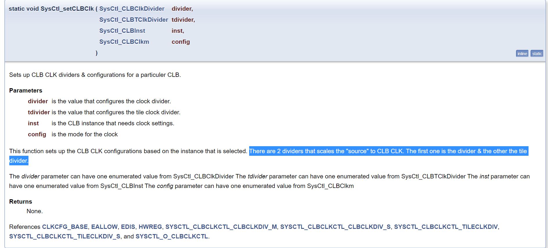

Some doubts about CLB clock:
1) CLB max clock is 100MHz, so CLBCLKDIV should be 2 or larger values
2) TILECLKDIV, what's the max frequency? Can TILE clock be lower than CLB clock?
Do we have a detaild doc?
Br, Jordan
    Yes you are correct that there are 2 dividers that scales the "source" to CLB CLK. The first divider can provide a division upto 8 while the second one (tile clock divider) can provide a division upto 2. The details of the API and the parameters to configure it are available as part of F2838x Driverlib API User guide (inside C2000Ware) as shown below :

  • Himanshu,
    CLBCLKDIV is the divider from system clock (200MHz).
    What about TILECLKDIV? Is it from system clock or CLB clock?
    Br, Jordan
  • Jordan,
    TILECLK is the divider from the CLB clock so yes it is possible that TILE clock to be lower than CLB Register clock.
