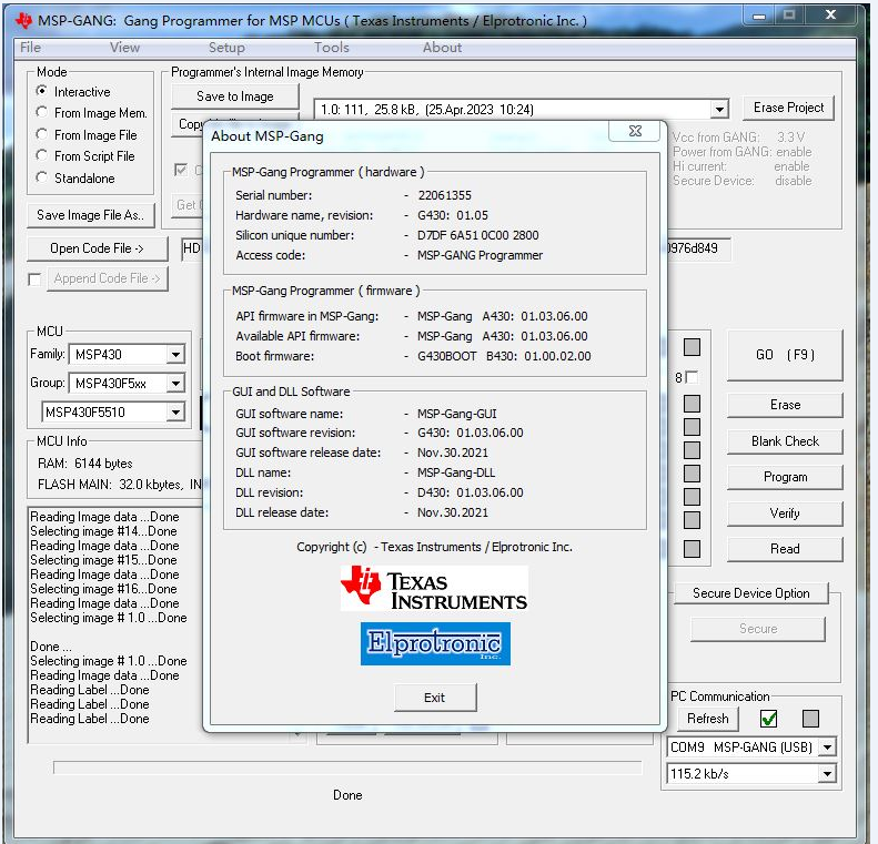

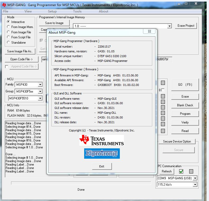

Thank you for trying this.
Can you share a capture of your About window in the MSP-GANG GUI? Go to "About -> About" with the GUI open and your bad programmer connected.
Also, can you try reducing your SBW speed from fast to slow? Just hit the "Interface Option" button to do this. Then try programming again.
If neither of those reveal anything, I would say your MSP-GANG probably has a hardware issue. Where did you purchase it from?

Hi Hari,
The customer replied as follows:
Following Brandon Fisher94's recommendations below, I looked at the two burners as shown below. The SBW speed is adjusted to slow, which also does not work, and ERROR 33 still appears
Please arrange a return!!
