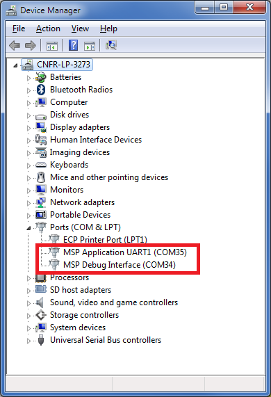

  • What is your operating system?
    Can you please provide an screen capture of your device manager?
    Are you able to see the below two devices in your device manager?
    Mo.
  • The operating system I use now is Win XP.
    I captured the screen but I can't find these two devices.
  • It seems that for some reason the on-board 4-port USB Hub (TUSB2046B) is not enumerated correctly.
    You can run the free tool "USB Device Tree Viewer" to see more details:
    Mo.
  • So how to solve this problem? That means I need to install the drive of TUSB2046B?
  • The Hub is an USB standard class device. So you don't need to install anything by your self. The driver will be automatically installed by your operating system.
    Have you tried to connect the board to other USB ports?
    If that doesn't help, my best recommendation is to return/replace your board.
